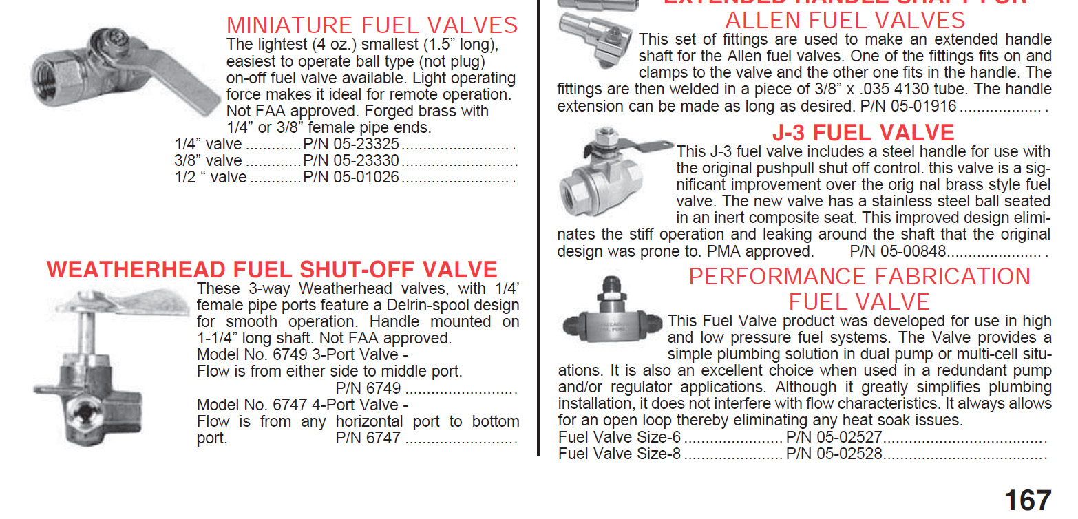

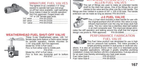

My plane had no taps at all when I bought it and all I could find were large, heavy and ugly as sin.
I ended up fitted four brass gas taps, the lightest and smallest fuel taps I could find. Not being designed exactly for the job, one side is shorter than the other, but I managed good seals on the rubber fuel lines.
Three have given reliable service until recently. One always leaked fuel, even when closed, and I used to squeeze the tapered inner part into the outer housing to try to seal the leak. Now the others have also started to weep petrol. Not ideal. Can anyone suggest an better alternative?
Regards,
Lyle
Lyle here's some that Aircraft Spruce have on their books. Their Brisbane agent might have them in stock even.
[ATTACH=full]938[/ATTACH]
[ATTACH=full]939[/ATTACH]
