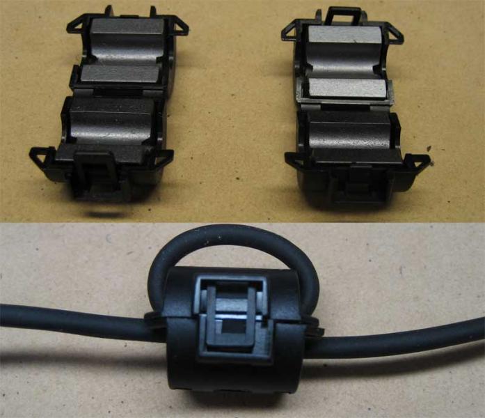

Guest Michael Coates Posted December 4, 2008 Posted December 4, 2008 Re: Radio Issues... I would bet money your cords are simply worn out from years of abuse, sorry i mean use. If you flex the cables at the plugs by pulling the cable instead of the plug when you take them from the plane you will wreck the shielding really quickly and thats your problem. Find a new name brand headset and try it instead. IMO David Clarkes are always the best to use for checking planes (but they must be good (new - not 20 years old)). If it works there will be a picture of a ferrite bead / core in a photo. You can buy these from Dick Smith/Jaycar etc... i have better photos at work to show you tomorrow.
Guest Michael Coates Posted December 4, 2008 Posted December 4, 2008 Re: Radio Issues... A ferrite bead is a passive electric component used to suppress high frequency noise in electronic circuits. Ferrite beads employ the mechanism of high dissipation of high frequency currents in a ferrite to build high frequency noise suppression devices. Ferrite beads may also be called ferrite cores, ferrite rings, ferrite EMI filters, or mistakenly as ferrous beads. Ferrite beads are similar to inductors in some ways but work especially in an area that is parasitic for general purpose inductors. They essentially act as a high impedance, or "resistor" to high frequency EMI/RFI electronic noise. The absorbed energy is converted to heat and dissipated by the ferrite, but only in extreme cases will the heat be noticeable. Ferrite beads are one of the simplest and least expensive types of interference filters to install on preexisting electronic cabling. For a simple ferrite ring, the wire is simply wrapped around the core through the center typically 5 or 7 times. Clamp-on cores are also available, which can be attached without wrapping the wire at all. Courtesy of the internet.

Guest Michael Coates Posted December 5, 2008 Posted December 5, 2008 Re: Radio Issues... Here is the picture i promised

djpacro Posted December 28, 2008 Author Posted December 28, 2008 Managed to get flying today with a headset that is normally unusable in the front seat. Worked 100% with the ferrite core. For info, a simple story on the subject at http://www.mglavionics.co.za/Docs/EMI%20suppressor%20for%20VHF%20frequencies.pdf
