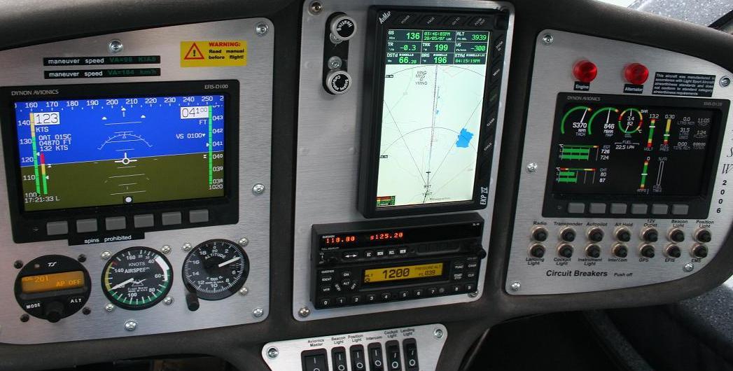

Actuals from the Dynons - Note, ignore the green arc on the backup ASI as it is for the USA:
TAS 132 knots
ASI 123 knots
GS 136 knots
Revs 5,370
Alt 4,100
Temp 15 deg

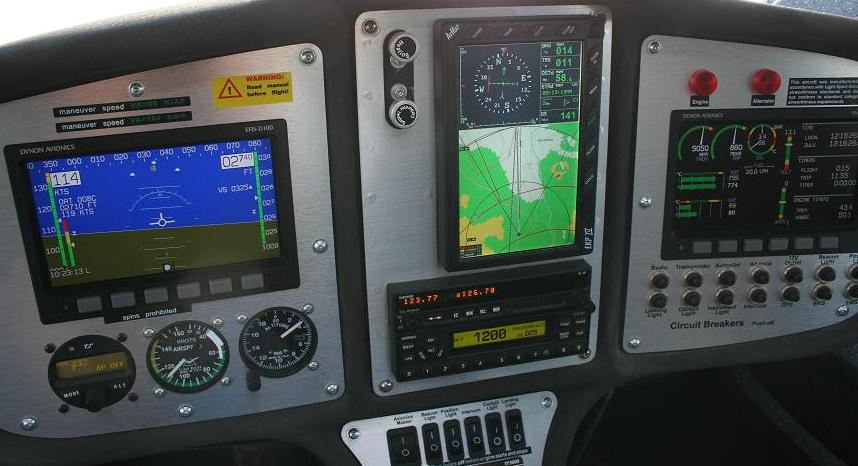

[ATTACH]2403[/ATTACH]
TAS 119 knots
ASI 114 knots
GS 141 knots
Revs 5,050
Alt 2,740
Temp 8 deg
[ATTACH]2404[/ATTACH]
Guest pelorus32
Hi Ian,
the data is anomalous because in the first example you have a descent of 100fpm and in the second a climb of 325fpm. Interestingly your AOAs in both cases are high on the green.
Also in example 1 5370rpm is about 93 HP - see attached PDF
Regards
Mike
912Sperf.pdf
912Sperf.pdf
912Sperf.pdf
