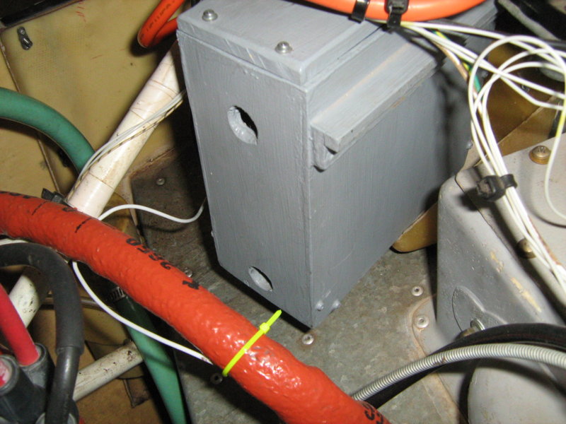

The battery is a 13.2 volt 30C , 8.4 amp-hours. Weight 950 gms I think. LiFePO4 which is not flammable. From hobbyking for about 100 dollars.
It is rated to have 8.4 times 30 or 269 amps for cranking. All I know is that it belts the motor over better than the Odyssey did.
I put the battery in a plywood box so that it would fit where the old battery did, and painted the box grey to make it look more technical.
Now the downside of these batteries is that they cannot be discharged too much and they can't be overcharged at all. They have no vents and if they are mistreated they puff up.
The Jabiru voltage regulator will overcharge these batteries. It produces about 14.9 volts and the LiFe batteries can't take more than 14.4, although a bit over for a short time doesn't seem to hurt them.
So I got a digital voltmeter ( about 10 dollars) and a few big capacitors.
The battery is just connected where the old one was. No change to the rest of the plane wiring except that the capacitors were put between the positive and negative bars in the instrument panel and the digital voltmeter on the same bars.
In operation, the engine is started as usual EXCEPT that when the voltmeter shows 14.4 volts ( usually before taxying is even started) then the master switch is turned off. This isolates the battery so it is no more likely to start a fire than when it is sitting in the hangar.
The alternator now thinks the big capacitors are the battery and the radio works just fine from this.
I am well aware that I have made the system non-standard and this is a bit of a worry. It would be quite possible to automate the disconnection of the battery from the voltage regulator. My daughter in law is likely to be flying the plane soon and I would like to make it standard for her. But in the meantime it all works just fine.

Heres a picture of the battery
