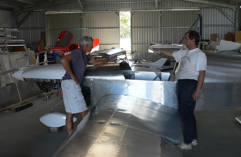

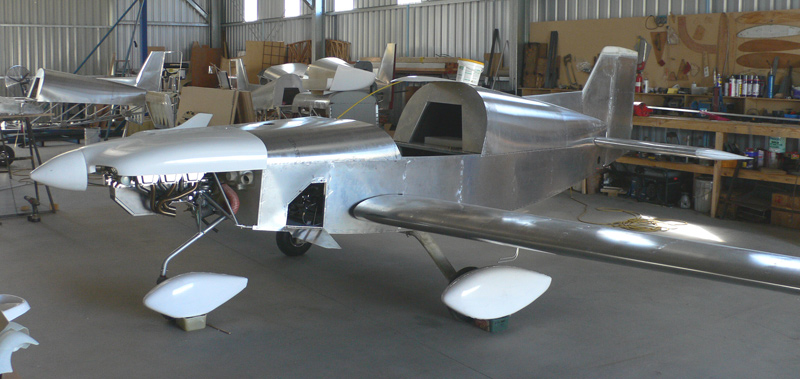

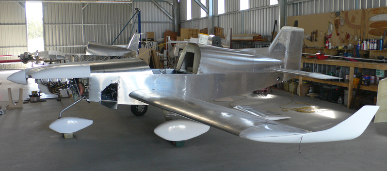

I know there is a lot of interest in the Cheetah Sierra. I have been there for much of the building of this sweet bird, and have even contributed a few things here and there to its build while building my own Cheetah 100 (Garry's idea - I prefer Cheetah MKII) in the same hangar.

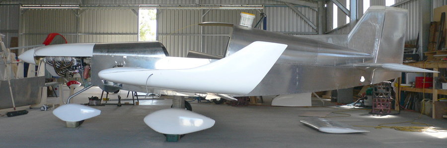

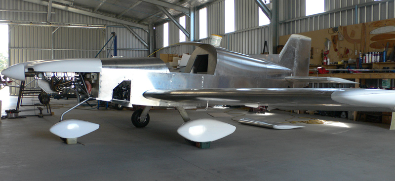

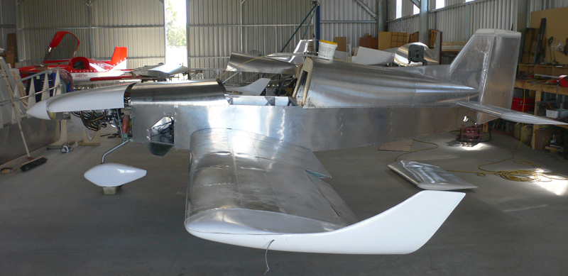

Garry is fairly web-illiterate, so I thought I'd post some photos of its current state.
Enjoy.
[ATTACH]3475.vB[/ATTACH] That's my baby in the background.
[ATTACH]3476.vB[/ATTACH] The wheel fairings are propped up on ice cream containers. These will be removed before flight.

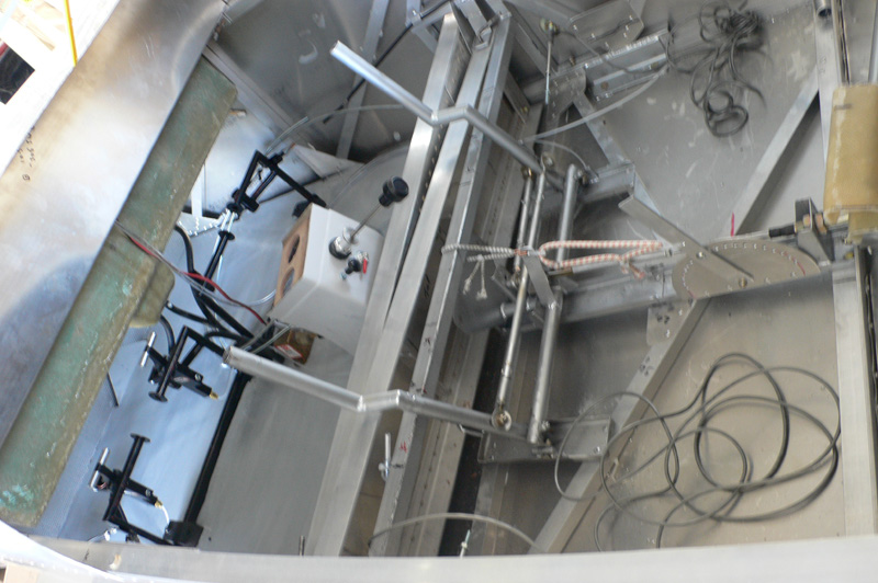

[ATTACH]3484.vB[/ATTACH] Dual controls. There will be dual differential toe discs when the third set arrives - I got the 2nd.

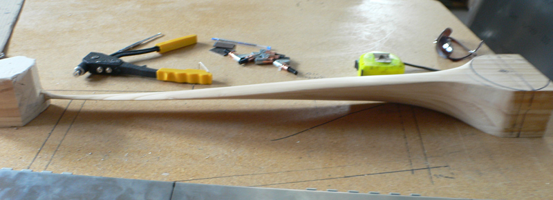

[ATTACH]3486.vB[/ATTACH] The prop blank he designed for the Sierra. 60/60 with more meat in the centre.

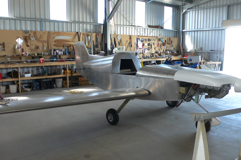

Here's a few from the last couple of weeks.
The Sierra is nearly ready to fly. Should be a goer next week.

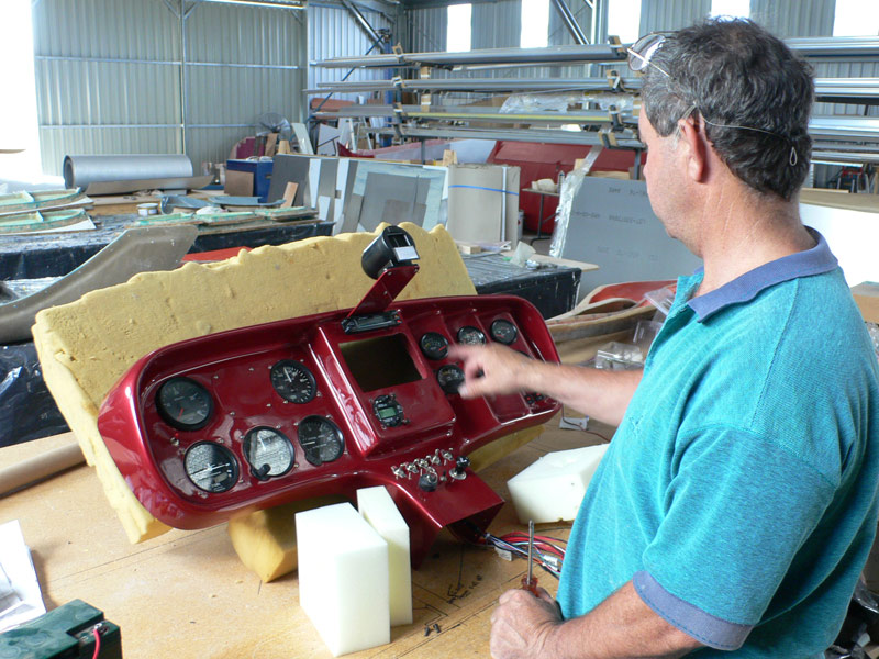

[ATTACH]3904.vB[/ATTACH] Garry finishing the panel. It took us a few hours to diagnose a problem where the co-pilot mic wouldn't work. Even tried my radio.
One of those electrickery things where even if the multi-meter tells you all is well, if you remove the wire from the d-plug and resolder it, it works.

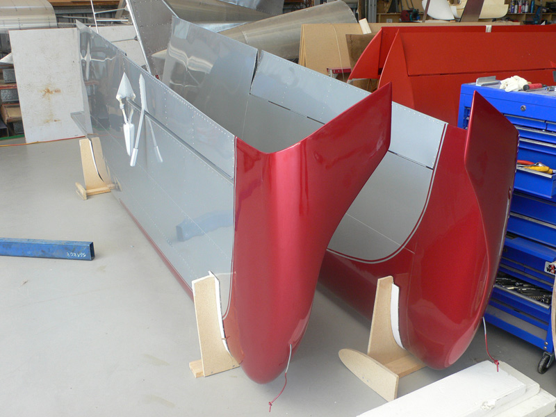

Pretty small elevator on that 2nd picture there Ross 006_laugh.gif.0f7b82c13a0ec29502c5fb56c616f069.gif
Well picked up Ian. I'd better call Garry before he tries to fly it.

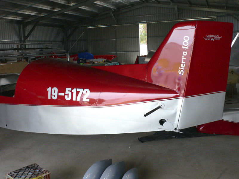

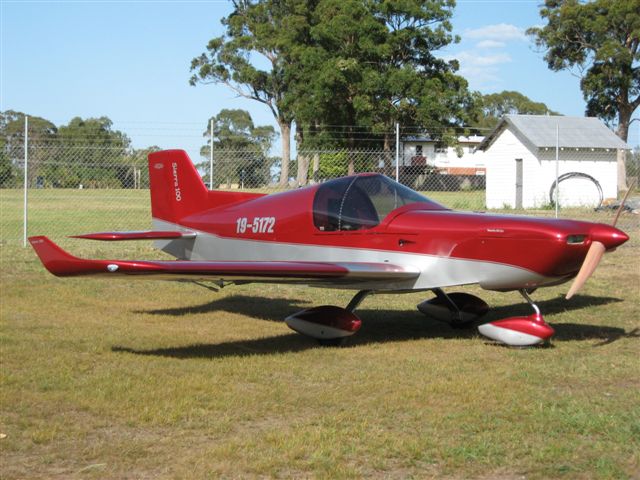

Got an email from Garry today with the long awaited news. Since no one else has posted it, here's the finished Sierra.
Gotta say I really like those colours.
[ATTACH]3952.vB[/ATTACH]
This is an awsom aircraft it will be improved when he fits the moulded canopy which is coming soon, I have to tell you I believe that Garry is on a real winner and all Australian made, now that has to be a plus.
I got to tell you all that I'm in love (come on lotto)
Don
Considering he started building it in July, and spent a few weeks designing things like dual controls, and is a very busy man, that means it has a very good build time.
Remember, there is a temporary special price on it, so be quick.
Garry spent yesterday pulling out the joysticks and redoing them. For the next one he is going for a redesign. He knows how they should go now.
No point me taking more photos because the canopy and cowls were off all day, so he will send some better shots soon and I'll post them here.
The completed plane weighed in at 313Kg. Much lighter than expected with an all-metal construction with thicker square tubes and a 6 cylinder 3300. Lots of useful payload left.
The 60/60 prop didn't work out. The engine ran to 4000 rpm completely unloaded. It wants something much beefier. I wouldn't be surprised to see this plane go 150 knots in cruise. Garry will make another prop - about 68 with more mass outboard.

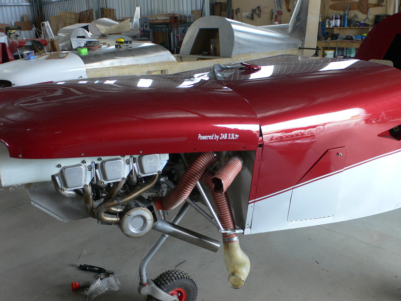

Some more pics, Not sure if one is the same as earlier post, but it looks pretty enough to have it on again.
