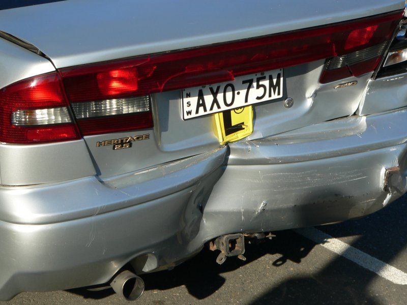

I can get a 2.5gen3 engine, just had 100,000 service done (runs smooth) Daughters car was rearended ,
make an offer before the greedy insurance takes it away

Subaru Heritage My02 ,2001 build date,2.5 ltr, gen 3,106,000 klms on the clock, very well maintained as her son{senior Subi technician} does it at cost at work.
Only boot and bumper, it still drives straight. Her youngest sons 3rd driving lesson, and he was stopped at the time.
spacesailor
