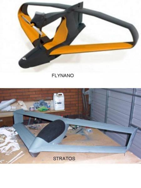

Any recent news you can tell about the Flynano? It's gone awfully quiet for the last nine months or so. I'm aware of the northern winter issue but we only saw a take-off with a conspicuously absent landing (last seen heading for grassland on the edge of the lake).

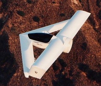

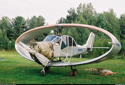

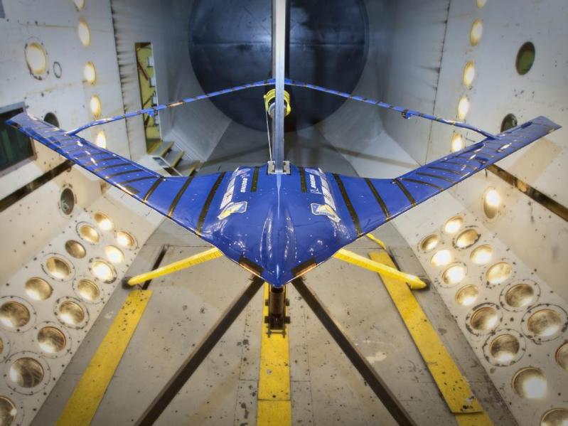

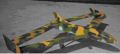

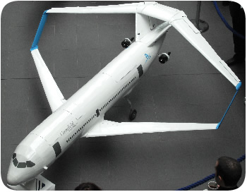

I'm also interested about the configuration, I guess they must have their IP Applications filed by now so can you tell us anything about what they consider to be patentable? To me it would appear to be much the same as other joined wing, closed wing and box wing aircraft some of the concepts of which have been around since the 1920s, some examples pictured below.
Also - do you know what has been done to address the inverted stall issues that seem to plague this general design concept? It seems to be insurmountable in the Stratos and the Flynano looks very similar in layout and probable CG position.
