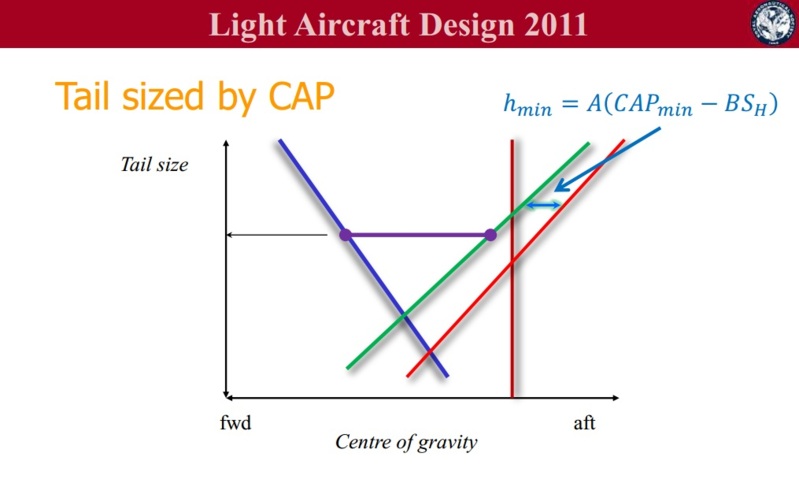

djpacro Posted March 12, 2013 Posted March 12, 2013 Classical processes for the design of light aircraft to meet handling qualities specifications are described in this slideshow: http://aerosociety.com/Assets/Docs/Events/671/Gordon Robinson.pdf Simply copying the layout of another type works OK. The section headed "Bite the Bullet" can involve a lot of labour (if warranted) but can also be done very effectively and without a lot of effort by using the estimation techniques provided in NASA CR-1975. For example, development of the classic charts of tail size vs cg plotted for required static margin at aft cg and elevator authority at forward cg. Then the note: Wide range of ‘acceptable’ static margins~3% to ~15% of MAC. • Tail area depends on wing x location as well as static margin. • Tail contribution to static stability proportional to tail arm, but damping proportional to square of tail arm. It then moves on to consideration of Control Anticipation Parameter (CAP) as a better way of selecting tail size and moment arm etc than a simple static margin. The arithmetic is no more difficult but gets to the heart of good handling by consideration of parameters determined from vast amount of data from pilot assessments of handling qualities. And all quite straightforward using simple methods of estimating data from NASA CR-1975. The attached diagram shows how the end result of the calculation may look. The blue line on the left is derived from forward cg control limits - typically elevator required to rotate on take-off or flare for landing. Lines on the right derive from aft cg stability considerations. Side by side seating usually results in a smaller required cg range than tandem seating - obviously consider fuel and baggage in the cg range required then simply select the size of the horizontal tail to suit. 1 1

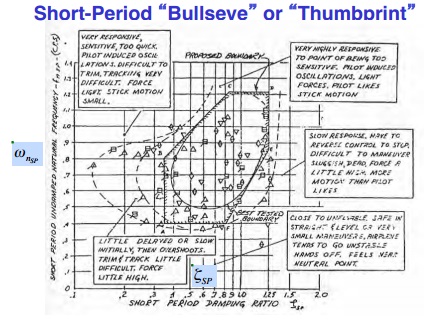

djpacro Posted March 12, 2013 Author Posted March 12, 2013 It is also useful to look at the Short Period "Bulls-Eye" for longitudinal handling characteristics. i.e. put your design in the centre ring. (From: http://www.princeton.edu/~stengel/MAE331Lecture17.pdf)
