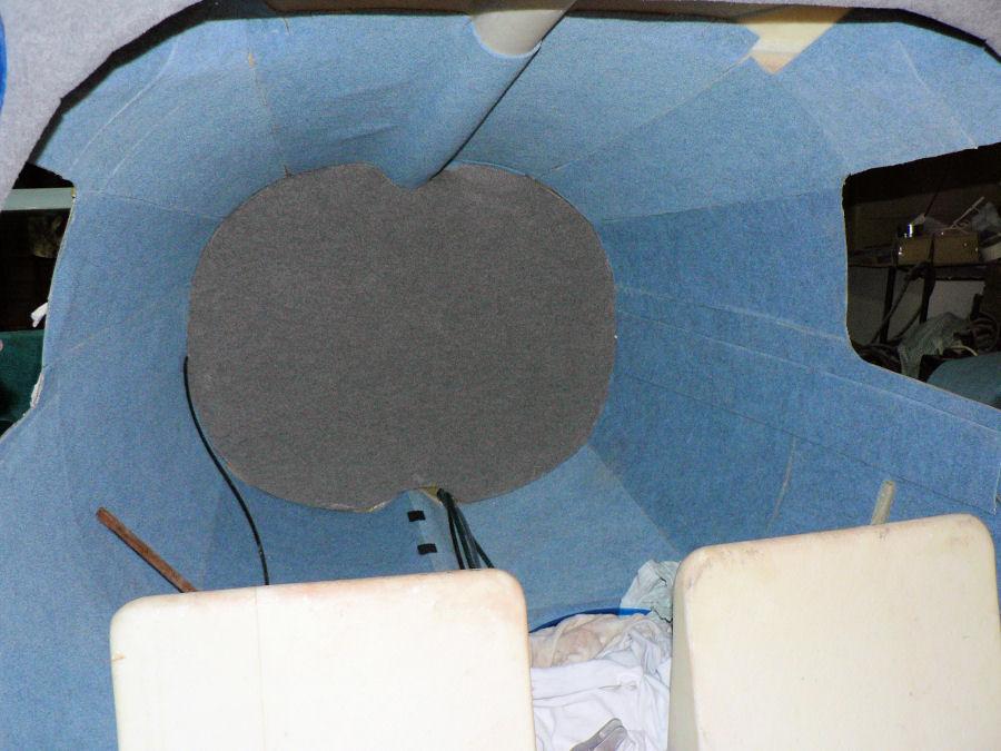

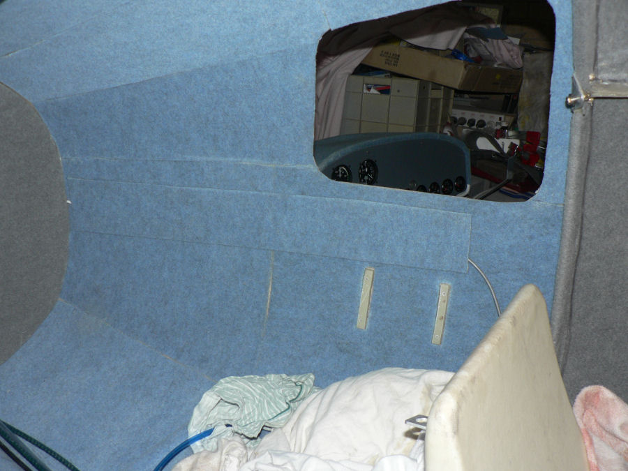

Well I have got most of the lining done and some felt on the instrument panel housing and the aircleaner mounted on the engine side of the firewall. Tomorrow, hopefully, I should get the firewall lining done and the instrument panel mounted in the cabin. Note the difference between my J160 panel and Geoff's panel. I am still deciding where exactly to put the carby heat cable through the firewall! It is a bit cramped!
[ATTACH]809[/ATTACH]

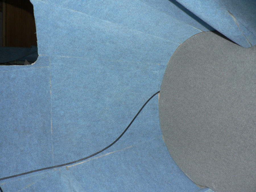

Sound curtain installed - Aerial leadwire on LHS - Strobe HT lead on RHS
[ATTACH]810[/ATTACH]

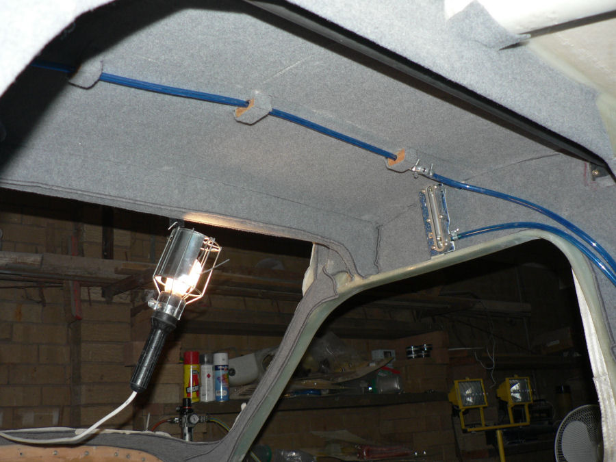

Luggage floor, walls and most of roof lined - strobe wire with cover on RHS & mounting strips behind pilot seat
[ATTACH]811[/ATTACH]
Aerial lead - Luggage floor & wall - Some joins to tidy up
[ATTACH]812[/ATTACH]
Strobe power mounting strips and covered strobe HT lead

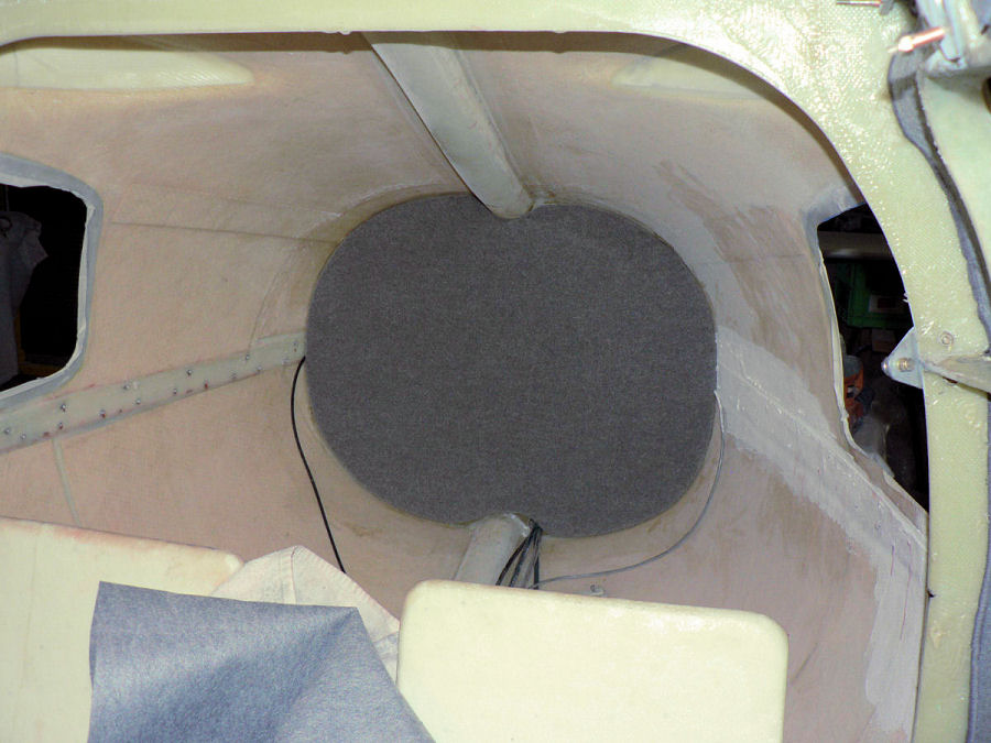

Passenger side cabin roof lining
[ATTACH]814[/ATTACH]

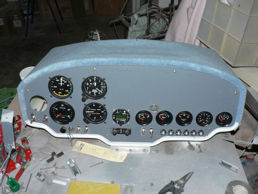

Instrument Panel attached to clamp felt - white (glue) blotches will largely disappear once they dry.

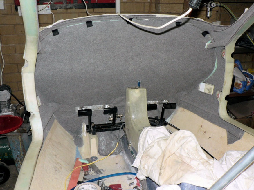

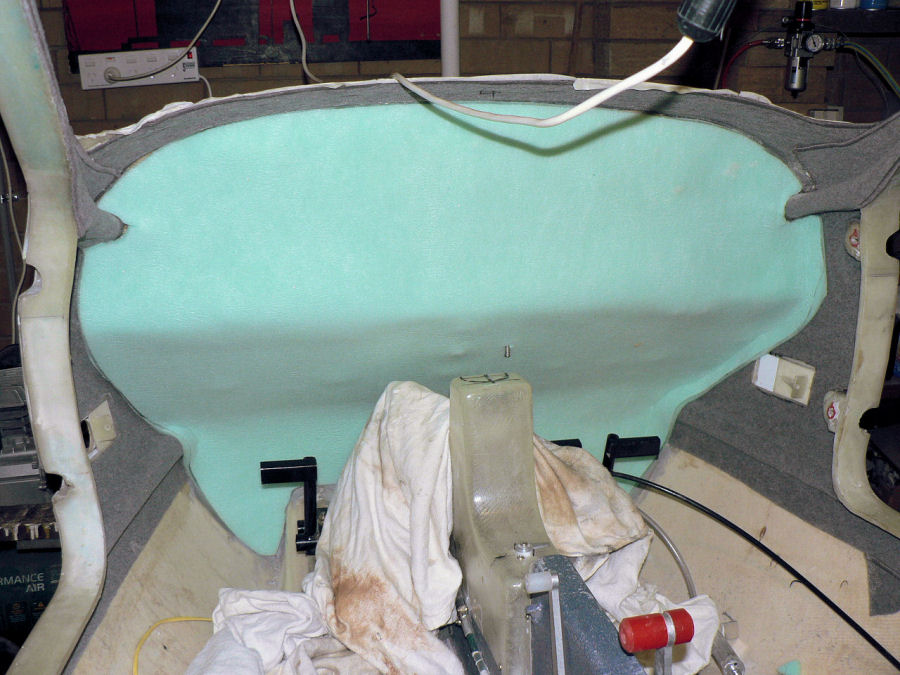

Disconnect fuel line - remove rudder pedal stops - Fit & glue the foam to the back of the firewall
[ATTACH]816[/ATTACH]
Fit & glue felt - Reinstall Rudder pedal stops - Connect fuel line
[ATTACH]817[/ATTACH]

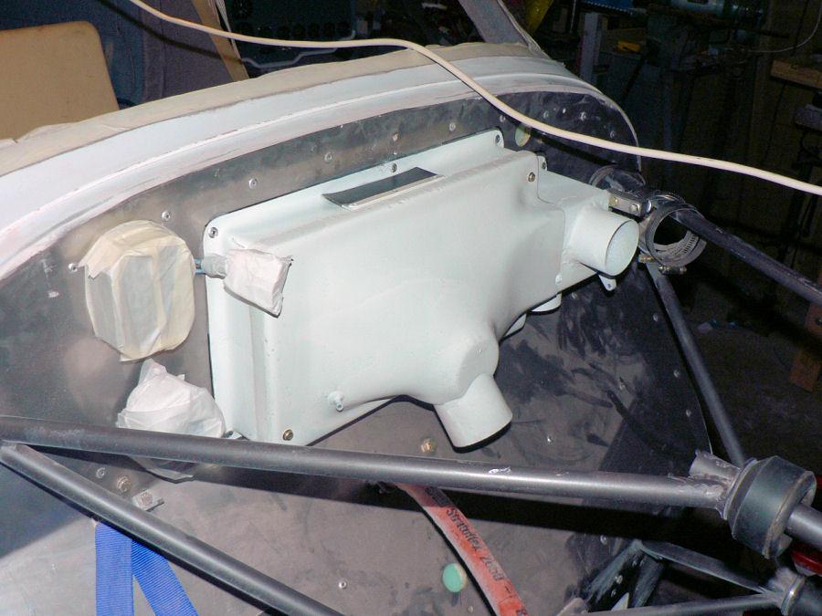

Paint air cleaner - Prefit & Pop rivet air cleaner to firewall

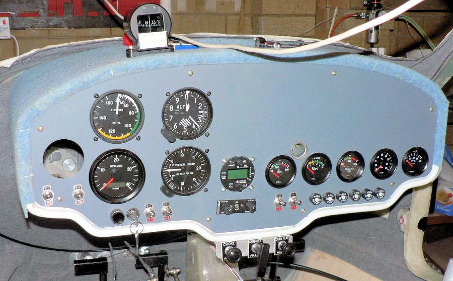

Found panel bolt holes in firewall and cleaned them out.
Cleared cable holes for choke & throttle, carby heat and cabin heat.
Used longer bolts by 1/8" for panel mounting - will check them later as the foam & felt compresses overtime.
Mounted compass on top of panel in front of pilot seat - used three brass mounting bolts, nuts & washers to eliminate interference.
The shiny, not stainless, steel panel mounting screw below and near the compass did not have a noticeable affect on that bearing of the compass whether it was in or out. I did not try removing the retained nut used by the panel mounting screw.
[ATTACH]818[/ATTACH]
The electrical wiring through the fire wall is not done yet.
The choke, carburettor heat & cabin heat cables are mounted below the panel to make access easier to the back of the panel.

Did more work on panel over weekend.
Got the battery installed and hooked up to an negative earth strap on the stainless steel firewall and to the positive starter motor solenoid on the firewall.
Because I have mounted the switches and circuit breakers close to the bottom of the panel I had to trim a lot of material from the fibreglass panel edges. The large size of the supplied switches does not help.There are a number of safer types on the market so that you don't end up with the possibility of a switch knob embedded in your skull. See Captain's switches - loverley.
The key operated solenoid to power the two positive panel busses is connected powering the main buss & the instrument buss. It works.
I have previously tested the temperature gauges roughly using hot water on the oil temp and a heat gun on the CHT and EGT.
The starter solenoid button works and is only live when the master switch is activated.
The radio is wired up to power and the aerial but not the sockets for headphones yet. A temporary single socket with a small speaker plugged in shows that it is picking up traffic as far away as Bathurst and Dubbo plus Melbourne Centre - all this in my garage at Leeton under a tile roof and some close large gum trees about 70+ feet high!

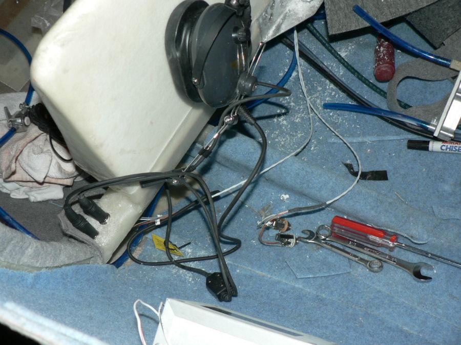

Ran the wires and installed the copilot radio jacks
Tied the head set wiresunder the beam behind the seats.
Installed the PTT button on the top of the joystick
Installed the radio MEM button near the top of the joystick allowing the choice of the next prerecorded frequency set in one of the radios 25 memory locations. It can only roll the selected frequency forwards from 1 to 25 then starts again.
Installed temporary power leads for the tail mounted strobe and tried the strobe with the radio going - the strobe power unit is producing a lot of interference on the radio as the charge builds up before it fires the strobe even after moving the power unit further back near the sound curtain.
Any suggestions?

Hi Roger, Geoff and Micgrace
Thanks forall the suggestions - I am working on all of them.
Essentially I am running the coax down the bottom middle of the fuse as far as the sound curtain then down the passenger side wall over the door and into the side of the panel. Once in there it is pretty hard to avoid all leads but I am in the process of lengthening some power leads under the panel to give more flexabilty in location.
The temporary low tension power leads to the strobe power unit are strung from the panel across the top of pilots seat to the strobe power unit. The Strobe high tension power leads go from the unit along the pilot side of the fuse to the tail unit. They cross the aerial coax at the base of the tail.
The whole thing might be better in the open away from the building and trees which must soak soak up some of the radio signal and therefore allowing the strobe RFI to be a nuisance, relatively stronger than normal!?
After trying a few things this morning I got to thinking of putting the power unit in a bucket of water to shut up the interference but settled on an empty steel paint bucket - that did not work either! To cut out the strobe RFI requires about another half turn or more of the squelch knob. I shall have to quantify that more carefully. At the moment the battery is on the charger. The RFI is stronger on some frequencies than others.
Well I had better go and try a few more ideas!

I can use the squelch to tune the worst of thestrobeRFI out. It takes anything from about 1/8 of a turn to about 3/8 turn of the squelch knob. That will get rid of the worst of it but there is still a noticeable improvement once you turn off the strobe. I don't know how much radio traffic distance reception is being reduced say an extra 1/8 to possibly 1/2 turn of the squelch knob.
They should be able to run flashing LEDs as strobes nowadays as they probably run on a far lower voltage than the classic strobe. I have no idea of what sort of RFI they produce if any. I might check it out. They seem to be used in lots more applications as they are a more efficient light producer than classic globes.
There is still a bit of panel wiring to tidy up and rearrange also I can not take the fuselage out in the open yet to test open air reception until I widen the existing temporary doorway of the carport - garage with no permanent door.
