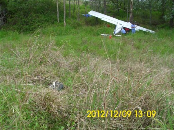

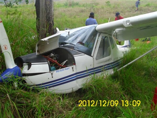

Viper Posted February 6, 2013 Author Posted February 6, 2013 Tha Hi Viper you did we'll to walk away from that. I had a look at the wreck and the cockpit was well intact.the floor held up well after loosing the undercarriage. They tried to start the motor no go so L2 arrived also a LAME ,they checked timing and other things no go then replaced both CDI units one try and it burst into life. L2 said he has had some CDI fail of late . Can I say keep an on the rev drop when checking Magneto it may be your only indication something is wrong. thanks for the update although as HITC said this does not make sense I would appreciate a update if it comes
