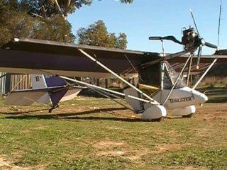

flyerme Posted January 20, 2015 Author Posted January 20, 2015 Do you have a photo of the wing underside? Curious, can't remember a single surface wing being built. No wuggers Oz, All the t- 83 were originally single surfaced( only have top wing batons none undernieth.
flyerme Posted January 20, 2015 Author Posted January 20, 2015 No wuggers Oz, All the t- 83 were originally [ATTACH=full]33768[/ATTACH] single surfaced( only have top wing batons none undernieth. Oh but had the patented collaspible main wing frames. Just No underside batons :)
Guest ozzie Posted January 20, 2015 Posted January 20, 2015 Pretty sure they had a full under surface but as you said no lower battons. If it had no under surface the compression and drag brace tubes would be visible. The Stolaero was single surface and then the Condor had a 25% under surface cruised a little faster and the Thruster went full under surface. check the image here this is the original prototype it had a lighter sail material so it is a little more transparent.
flyerme Posted January 20, 2015 Author Posted January 20, 2015 Yeh I always found it curious as to why they called them single surface but was told they called it that because it had no lower batons and the lower surface pushes up to the top making the wingframe visible in flight. But you would know more than I Oz
Riley Posted January 20, 2015 Posted January 20, 2015 Yeh I always found it curious as to why they called them single surface but was told they called it that because it had no lower batons and the lower surface pushes up to the top making the wingframe visible in flight. But you would know more than I Oz I'm pleased that got sorted Tim as I was reluctant to lock horns with a famous author but, like Ozzie, I'd never heard mention of or laid eyes on a single-skin-winged T-83/85 of any persuasion over the years. By the way, congratulations on the imminent launch of your book. Wishing you every success. cheers Riley 1
Guest ozzie Posted January 20, 2015 Posted January 20, 2015 It was only to separate the two types of wing skins. If one had to reskin then it would be beneficial to put a set of batons in. It should have been done when they were recalled to have the wing struts and other bits and pieces upgraded. And i've forgotten more than i remember of them.
Guest ozzie Posted January 20, 2015 Posted January 20, 2015 I was actually hesitant to say none had ever been built as nearly all the Thrusters where different in little ways when they were first built. They have over time been upgraded to the same standard.

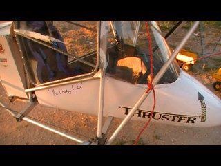

flyerme Posted January 20, 2015 Author Posted January 20, 2015 Yeh it had the recalled strutt mounts done but still sported the original skins. I planed on refitting top and bottom Baton skins with the help from Tony Tiffin but after a betsometer test on original wing skins decided to keep her as original as possible. I also found out ( not verified) that mine had the first factory retro fit doors and cabin back.?

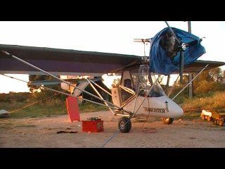

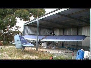

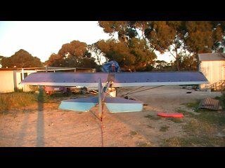

flyerme Posted January 20, 2015 Author Posted January 20, 2015 T83- 49 were made. In small batches , all a little different. Mine could never be determined having serial removed long ago, best guess was from an early batch? Note no jury struts. Bring back memories?
flyerme Posted January 20, 2015 Author Posted January 20, 2015 It ran the factory Fuji robin ec44... Beautiful engine
