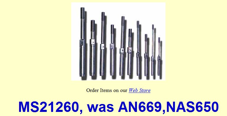

aj_richo Posted September 11, 2012 Posted September 11, 2012 Only affects fttings that scew into a turnbuckle barrel... not your thimble swages, might eliminate a lot of aircraft you are concerned about. However always pays to check any fitting before flight! All other aircraft at the 100 hourly or annually, which should be done anyway if you're on top of your maintenance

aj_richo Posted September 12, 2012 Posted September 12, 2012 Whats it going to be, the CASA version or the RAAus version? You quoted the RAAus to begin with http://www.raa.asn.au/documents/airworthiness/SB-002-15-08-2012-All-Aircraft-Control Cables.pdf PS I understood a terminal fitting to different to a thimble fitting
Guest Maj Millard Posted September 12, 2012 Posted September 12, 2012 It would be nice if they could be more specific about the particular cable in the photos IE: make aircraft ? local product or import ?...was the cable factory produced or other ?...........................................Maj...
