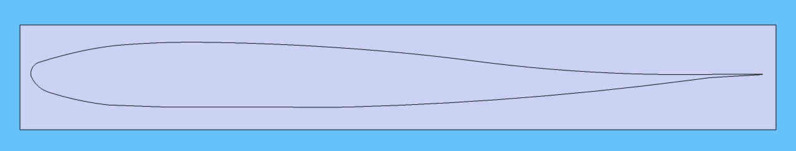

Drag a Rectangle big enough to cover your wing profile (Guess work usually) the size of the selected area is shown in the lower right hand corner of the work screen.
'Zoom Extents' to fill the screen and draw a mid height line across the rectangle. Now, using circles, arcs and lines, draw the desired profile making sure that there are no gaps between each segment. You should end up with something like this after you have cleaned up all the unwanted bits. My example is more complex than most 'normal' wings but I want you to see how easy it is, even if it looks complex.

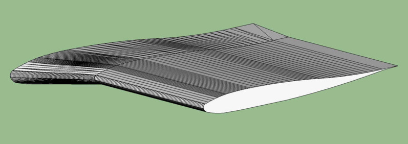

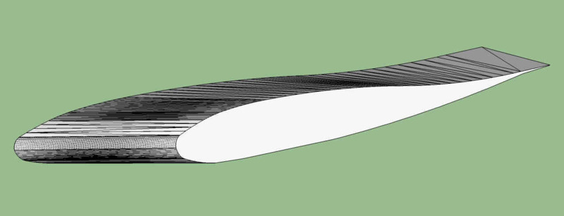

Use the rotate tool so that your image in seen in an isometric view. Then, use the 'Push/Pull' tool to extrude the shape 'out of the paper' so to speak. I have erased the rest of the paper as it is not needed.
All those lines you see are the 'Hidden Geometry' I mentioned earlier. Drag it out as far as you want it to go. For a simple high wing design, this could be the whole span IF it is to remain at a constant cord (length front to back)) I'm now going on to produce a double Delta design.
Use the Select tool (arrow) and click in the end face to high-light it. Then select Scale under the Tools tab or simply press the S key on your keyboard. A box will appear that encloses that selected face and on it will be 4 tabs, top, bottom, left and right. Unfortunately, these don't show in my exported 2D images. To shape the wing, all that is required is for the end face to be pushed or pulled into the shape you require. For instance, by clicking and holding the left hand tab, by sliding it back towards the trailing edge on the right, I add sweep and by dragging the top tab down, I add taper. If you wish, you can also add positive or negative sweep to the Trailing edge, and an upward taper to the underside of the wing.

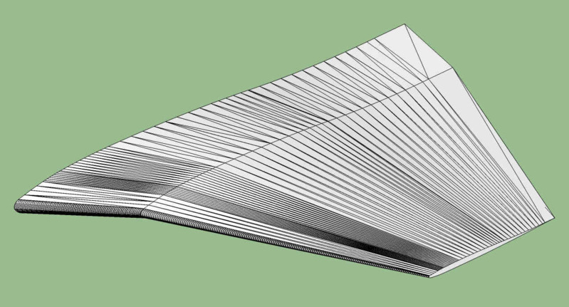

To take it a step further, reselect the end plane and extrude it again.
Now scale it as before to your liking. Getting the taper to be constant over both extrusions is a matter of practice. Note the forward sweep of the TE. Just hold the end tab you want to move. EXPERIMENT. It's fun.

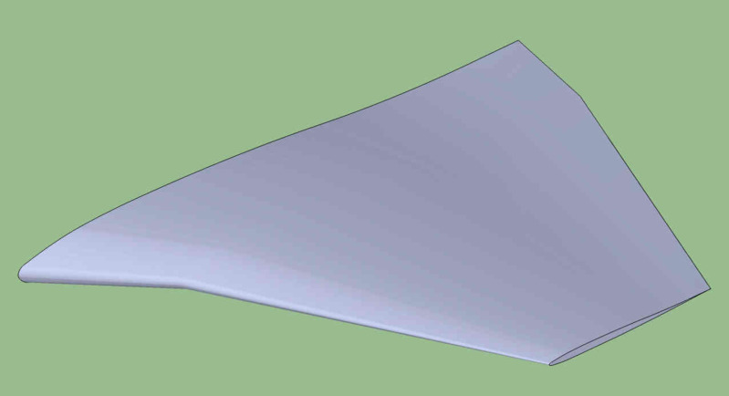

Finally, we have to clean it up. First turn off ' Hidden Geometry' if you have it selected, then under the 'Windows' tab, select 'Soften Edges'. A small wondow will open and you can smooth out edges and planes to what ever level you want. You will probably have to 'Select All' under the 'Edit' tab before this operation works. Whilst they are all selected, try 'Reversing Faces' if they are white. You can paint them if you like but I tend to leave that until later.

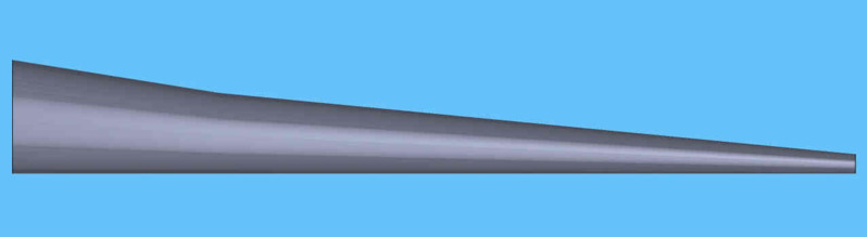

Front View, note taper change due to rushed work. Also the untapered bottom face. It all depends on your design. 794146603_frontview.jpg.87aa28ecca482e2c3d8bf9666f287ceb.jpg
Right Hand view.
