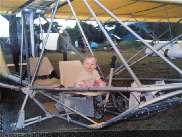

farri Posted March 29, 2012 Posted March 29, 2012 Sorry to get off topic but when I saw that Dragonfly, I just had to. That`s my old Chook, I built. Flew damn well too. I could stall it, hold the stick all the way back and by working the rudder so it wouldn`t drop a wing too far, I could have brought it all the way to the ground,fairly gently! Frank. Ps, I built it in the middle of the harvesting season, completely from scratch,making most of the parts by hand and I was so keen to get it in the air that I`d work on it every spare moment I had and finished it in three months...If anyone wants to know where it is now, just ask and I`ll tell you! 2

David Isaac Posted March 30, 2012 Posted March 30, 2012 ...If anyone wants to know where it is now, just ask and I`ll tell you! So where is it now Franko?
farri Posted March 30, 2012 Posted March 30, 2012 So where is it now Franko? Goodonya David! I was hoping someone would ask so I could tell the story. I just love to tell stories, True ones, that is. In December 1990, Cyclone joy formed off the coast outside of Cairns. By the time I realised that we were going to cop it, the wind had picked up to a point where I couldn`t pull either the Chook or the Drifter appart. I tied the Chook down as securely as I could, tied the Drifter down in the middle of the strip and had to leave them there, hoping that they would survive. Joy didn`t come onto the coast here but sat outside of Cairns, intensifying for several days. The wind peaked at more than 220 klm phr, at wich point it broke the wind speed gauge on Fitzroy Island, off Cairns. We coped it here constantely for 3 nights and 2 days, before it moved furthur south. The Drifter survived without any damage but the chook. had broken wing struts on one of the wings. A star picket that I`d used to tie it down with, went through the wing. The wind wreaked the shed I`d made for it so I pulled it all appart and hung it up in the shed where it stayed for several years. A husband and wife who had both done their flight training with me, twisted my arms until I let them have it..I rebuilt it for them, modified the engine mount and fitted their new Rotax 582 engine to it, made new skins for it, and they got it registered again..They flew it for years until a few years ago they decided to import an X-Air kit from France... They wanted the motor and prop off it for the X-Air, so it sits dismantled at their house in Cairns. Frank. Ps, I`ll bet you thought I was only going to tell you where it was. 3
