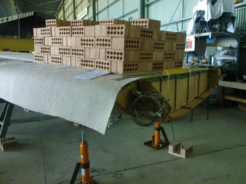

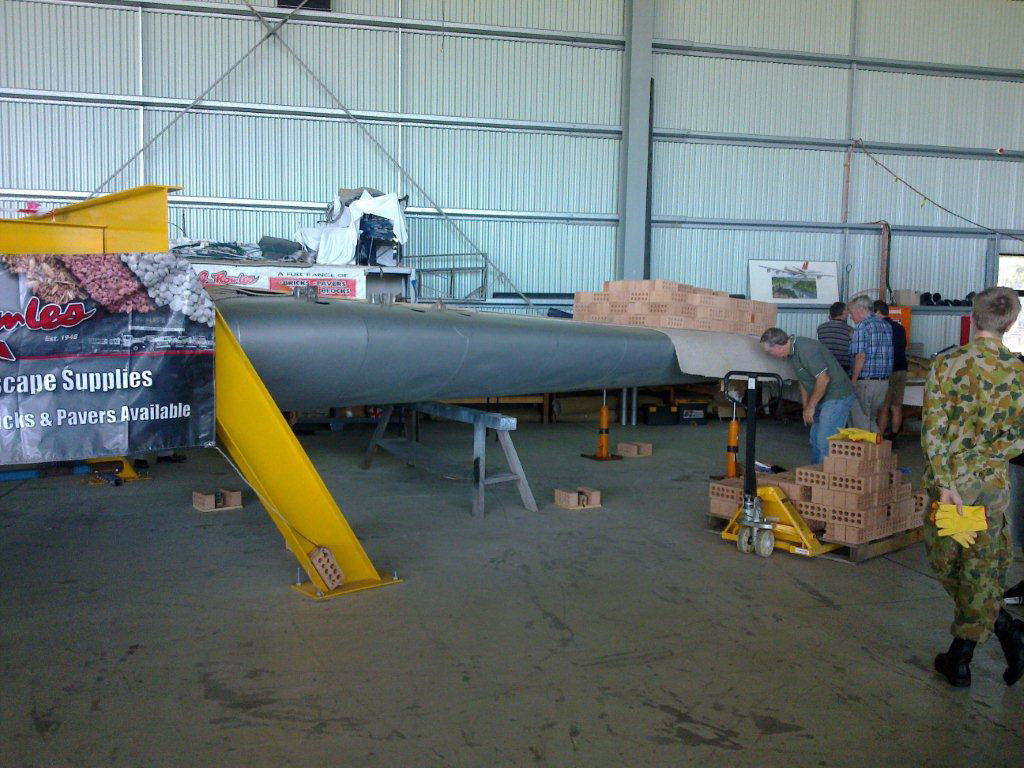

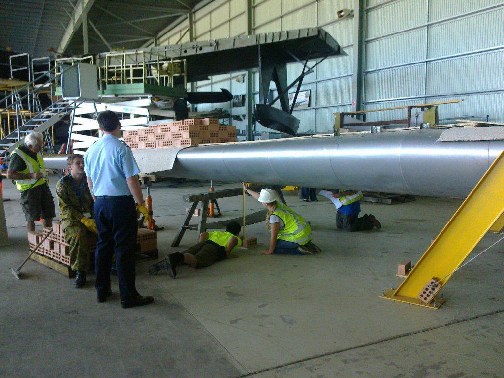

Next weekend air cadets will help test the damaged wing.
Volunteer HARS members already know one section of the wing, the largest wooden wing ever built in Australia, needs to be rebuilt but also need to know what condition the rest of the structure is in.773268498_2012018.thumb.jpg.1235f2b0f3676cf89c27e69e75f921d9.jpg
