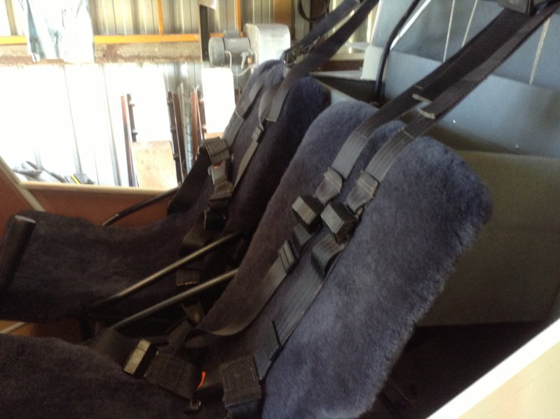

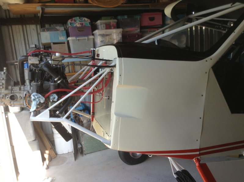

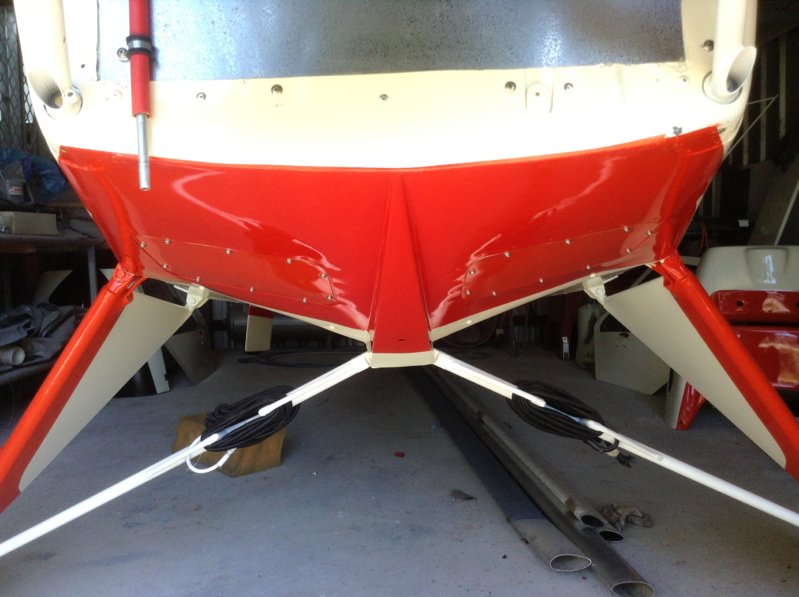

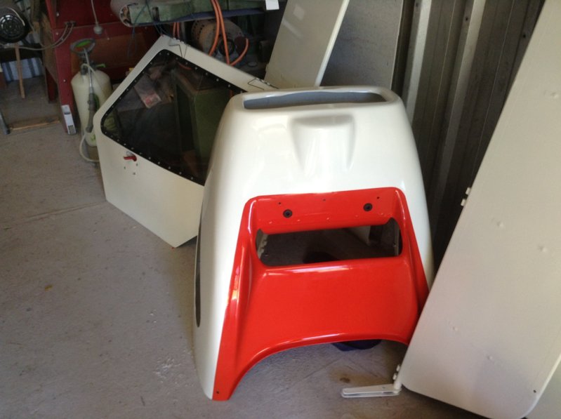

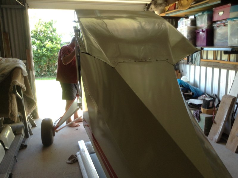

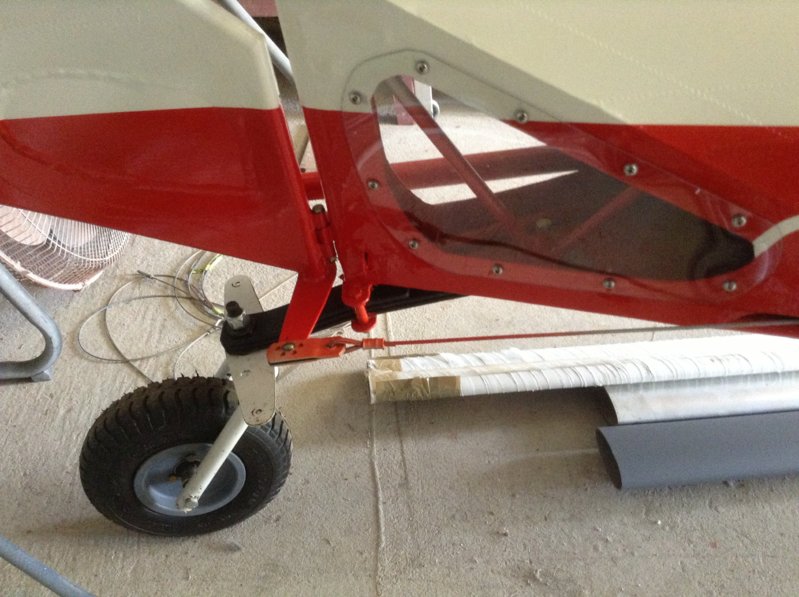

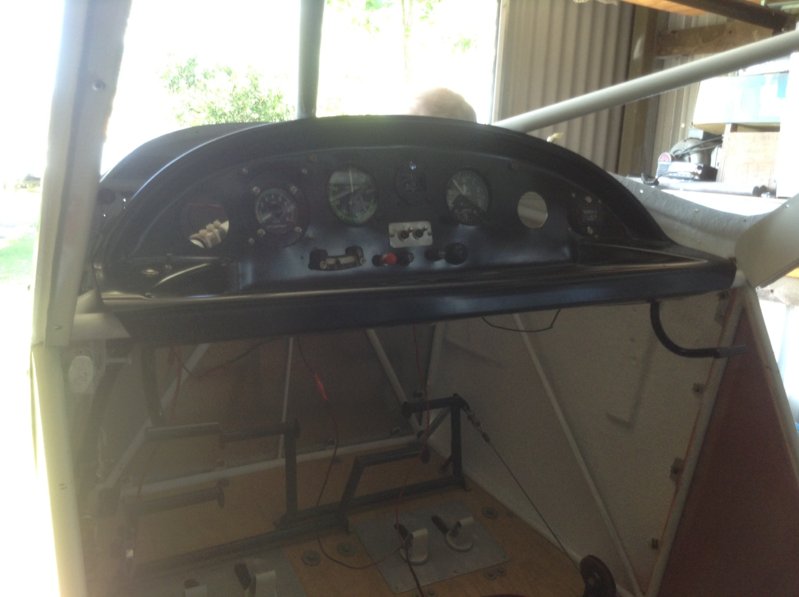

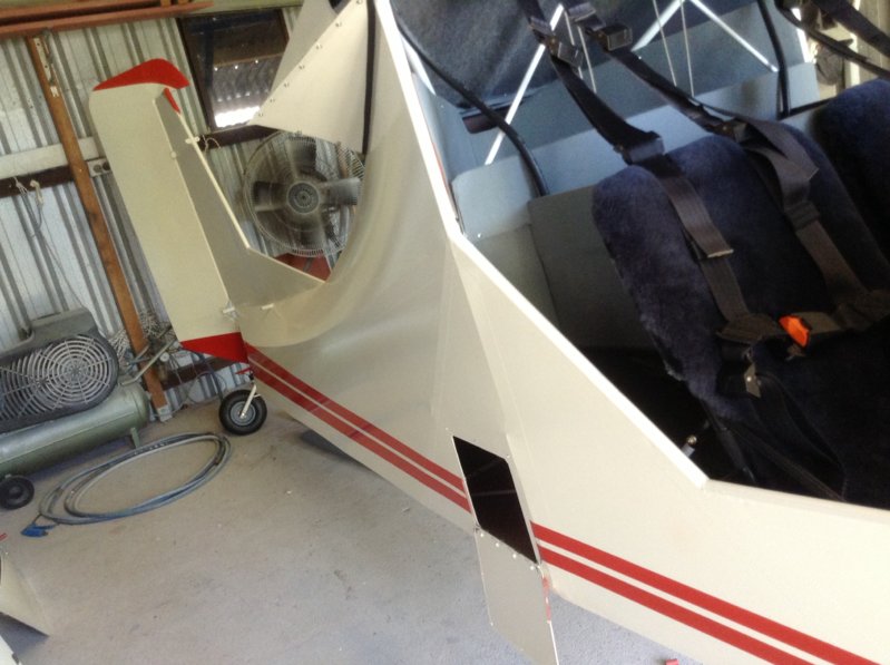

Guest Maj Millard Posted June 22, 2014 Posted June 22, 2014 Not sure how reliable the Aaeropower is, or parts availability etc. $26-26k don't sound like a bad price for a 582 if its in good shape with a good engine. I have a friend here rebuilding one currently that he picked up out west with 3000+ hours on it with trailer for about $10k...it is turning out to be in good shape and is going to be ery nice when finished. This example was as bad as you could imagine after 20 odd years of hard station use, but is coming back fine. Obviously if one needs a lot of work that should be reflected in a low asking price. will attach some photos of that rebuild as taken last week....Cheers Ross

seb7701 Posted June 22, 2014 Posted June 22, 2014 Thanks Maj - all very interesting to see, as they are proving to be an interesting prospect. That 582 looks tiny in that front end, but I like the inspection panel etc near the tailwheel. Very clever! What sort of money is involved in re-covering wings etc? Is Howie the cheapest option for that sort of stuff? Doug - that (in my book) is pretty decent performance for a 'real' plane with a 2 stroke Now, to find me a sound GR582 perhaps?

Guest Maj Millard Posted June 22, 2014 Posted June 22, 2014 Sebb, The gentleman restoring this one is retired and a true craftsman. He has also built several aircraft including original designs throughout his career, and as you can see the results are always impressive. I Look foward to being the one who will probabily get to run the 582 in for him, and possible test fly the aircraft when completed. Like Dougs 032 and David Sees early Lightwing recently featured in the magazine, the early ones are all quite lightweight and just a pleasure to fly really. They go quite well with the 582 up front, even two up, and Doug recently flew 032 down to Old Station for the second year in a row. Cheers.......... Maj....
