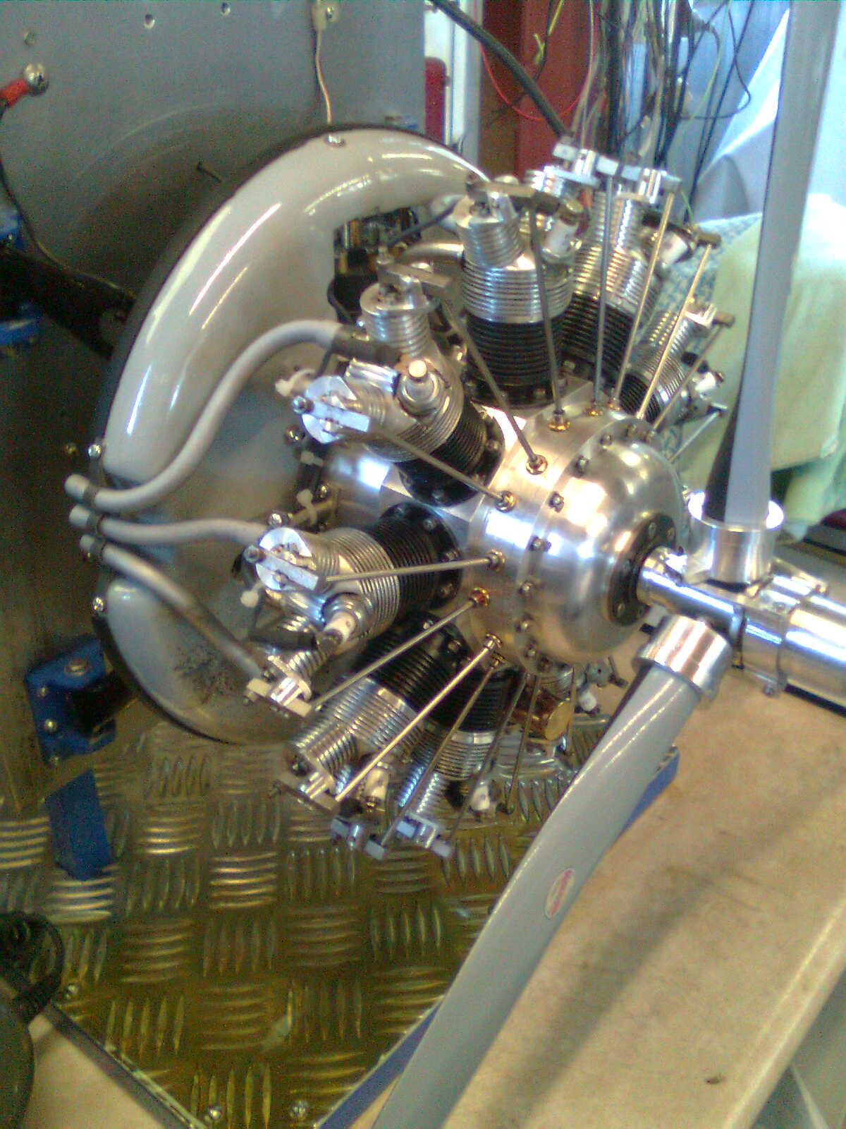

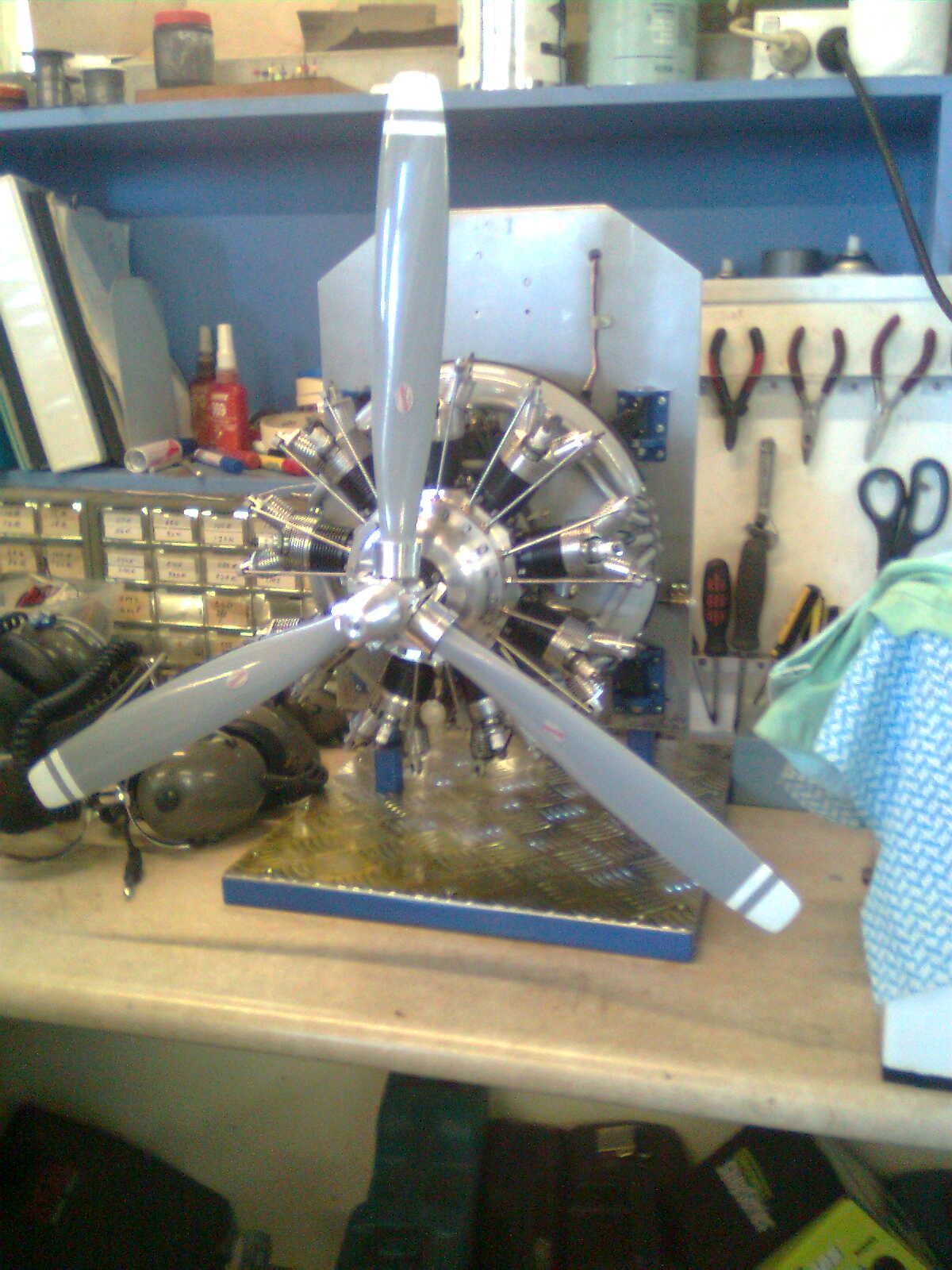

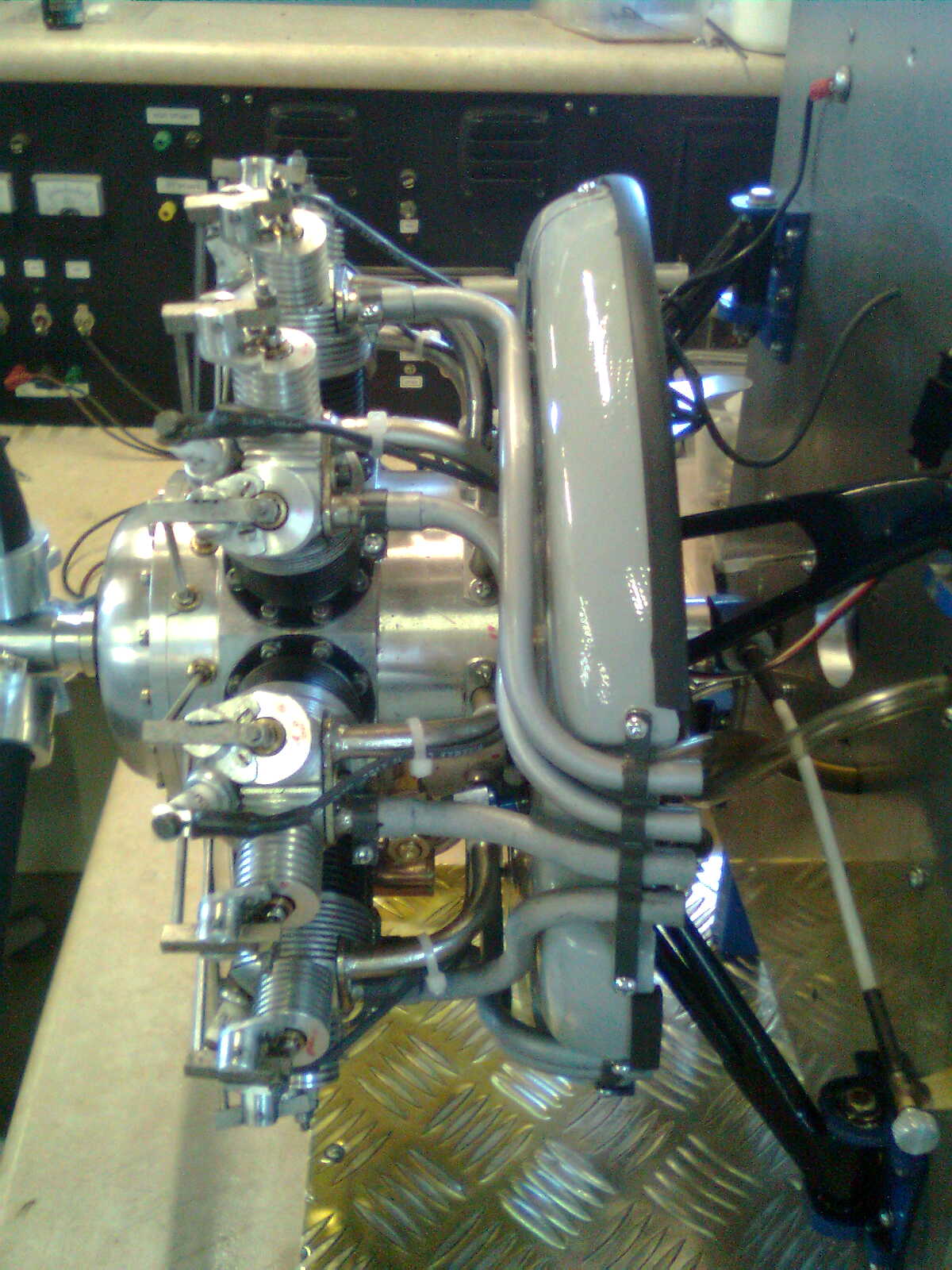

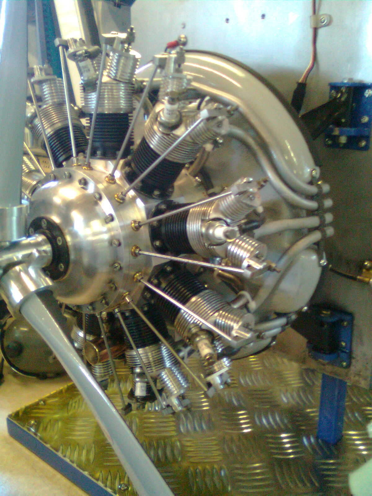

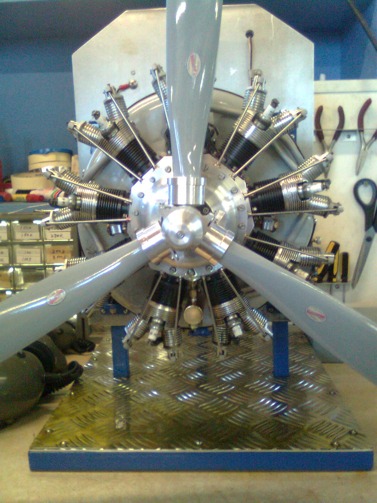

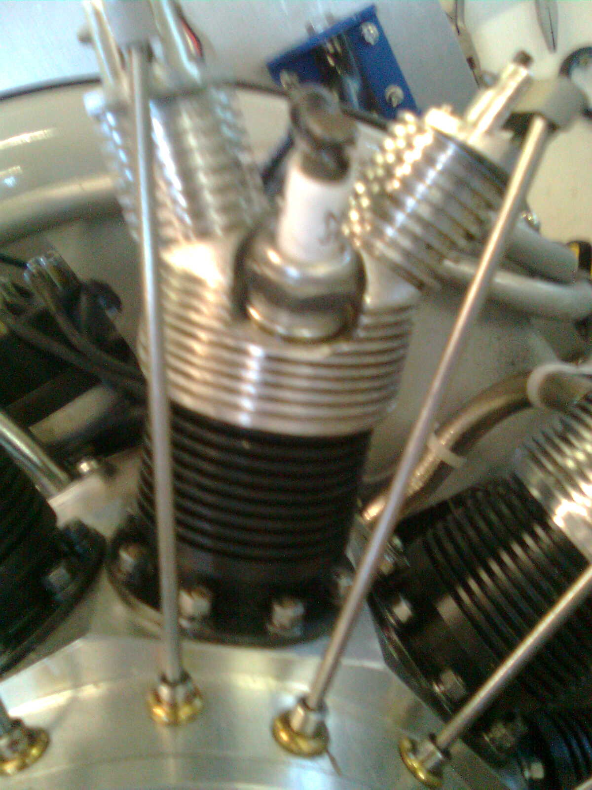

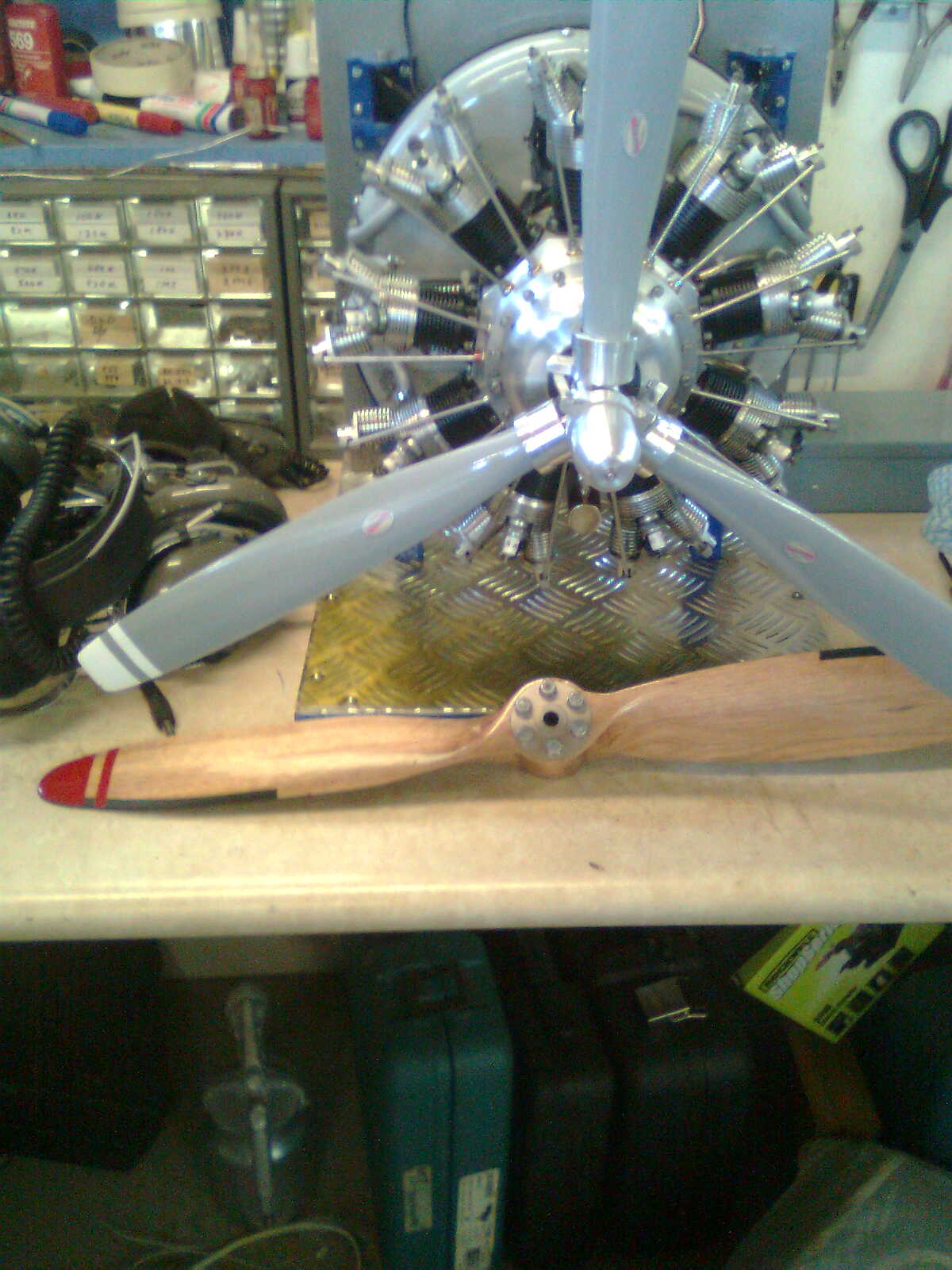

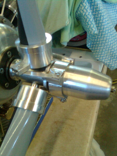

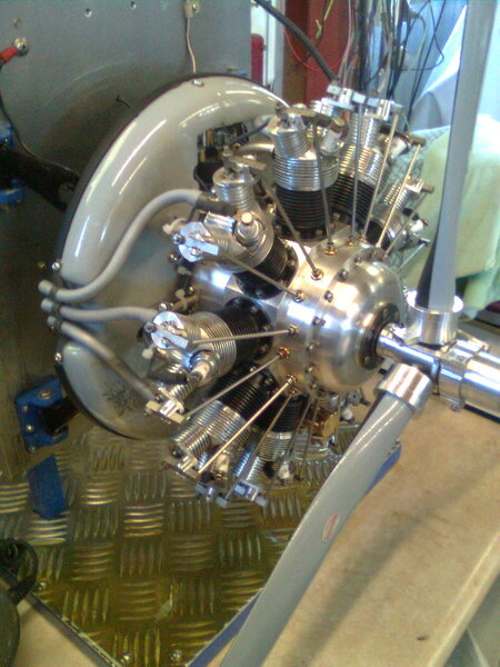

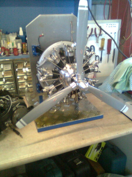

Photos of a small 9 cylinder radial engine a friend has made. It runs beautifully, and is based on the 985 Pratt and Whitney as used on the DHC-s Beaver, D-18 Twin Beech, Beechcraft Staggerwing, Winjeel and many others. The original engine uses an integral supercharger mounted on the back of the crank, and so does this one. Took less than a year to do.
Every piece including crank, pistons, rings, valves, valve springs, rods, oil pump etc. etc. were made in friends machine shop. A rear case casting and ignition parts were purchased but still had to be machined and assembled. The spark plugs used are the smallest made, and are actual spark plugs not igniters.

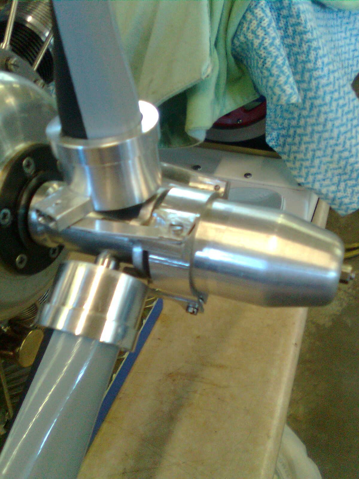

The propellor was also made from scratch, and is a copy of the 3 blader used on the Beaver, it also changes pitch of course..........Enjoy !!........................................................Maj...024_cool.gif.7a88a3168ebd868f5549631161e2b369.gif1486029497_Lakesidefly-in2011017.thumb.jpg.60b27c3758596542cdcca70da28d463d.jpg
Guest Maj Millard

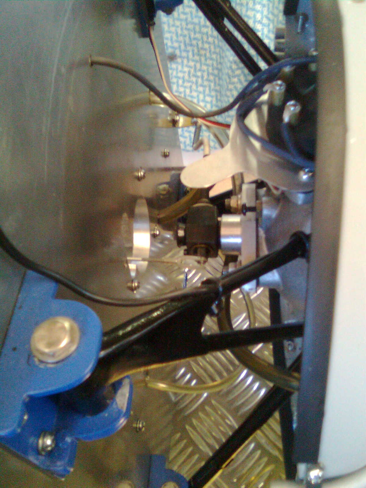

The prop is a little less than a meter in dia, weight - you can easily lift it and carry it, horsepower - we haven't worked it out yet. The full size one produces 450 Hp. I'll get some video next time he runs it.It has a separate oil tank, but he is currently using a little oil in the fuel to assist ring wear in (cast iron). I believe it has had an oil change already. Starting is by hand propping only, ignition is adjustable, and small throttle lever is behind support plate...One bottom cylinder threw a bit of oil out the exhaust, and kept fouling the plug until the rings seated.............Maj..

Biggest problem has been with the carb, the original didn't supply enough fuel. One currently on it is doing the job. My estimate on horsepower would be around 10-12 hp only. I love to hear it run,0409101144-00.jpg.d8d834bb6a8f8d5055a83aca52487374.jpg

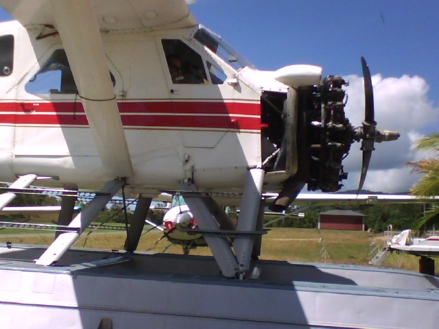

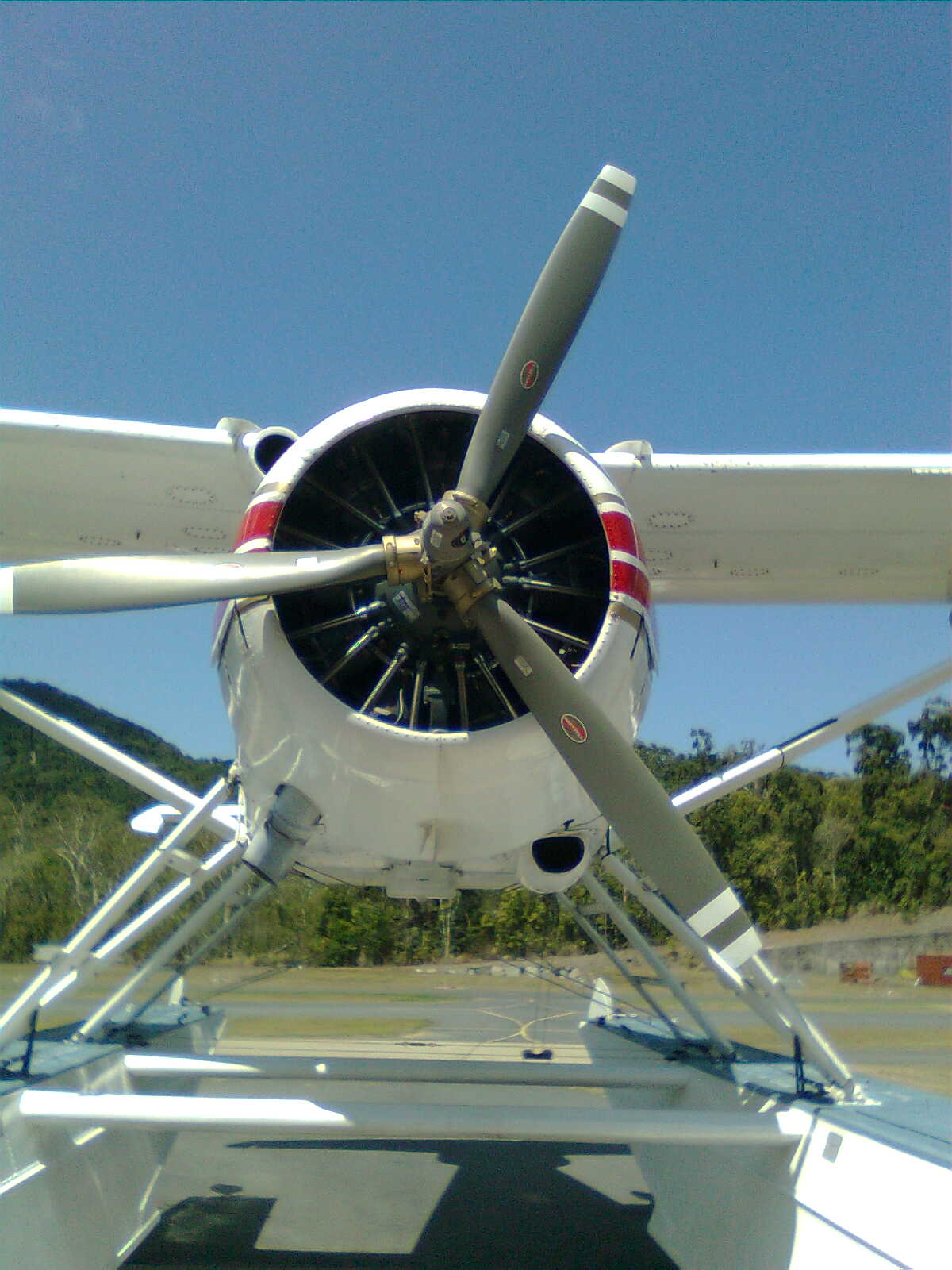

and stand behind it as it does move some air !....the photo above is of the real thing of course, it moves air also !...........................................................Maj...

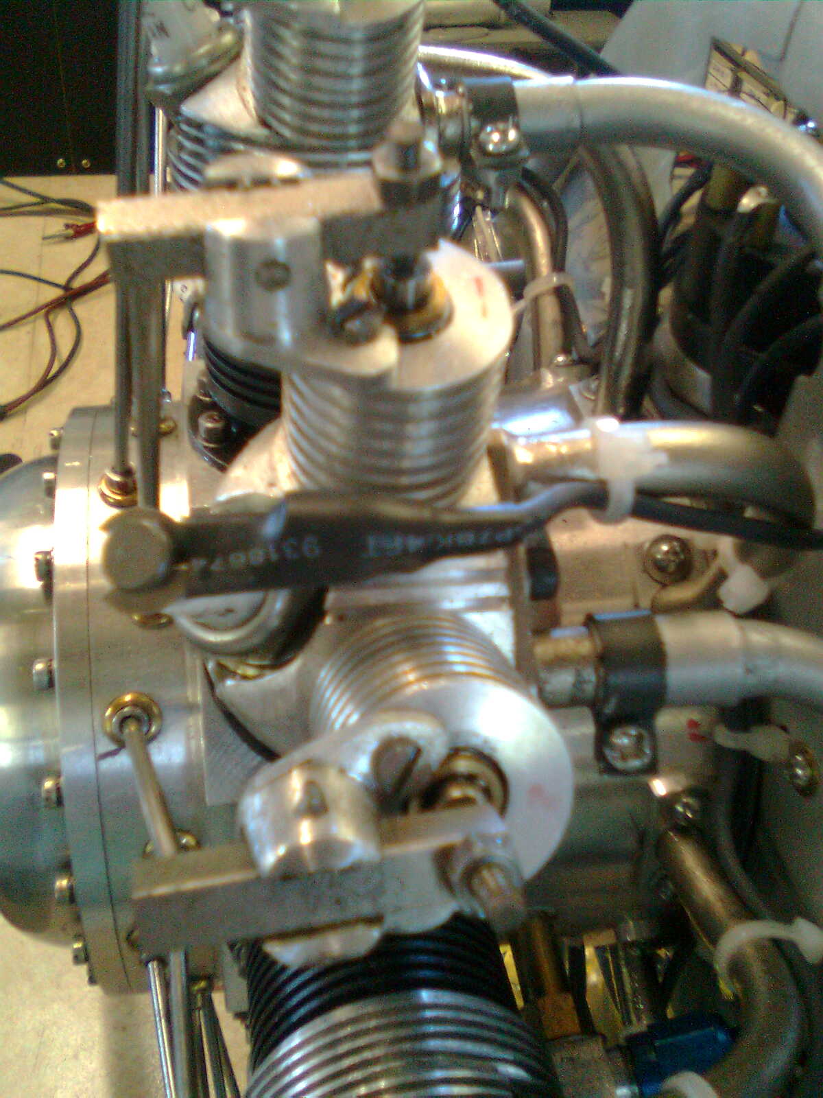

Guest Andys@coffs
Major
I was as impressed as all h&ll until I saw the photo shoing the HT lead being held to the intake manifold with <Gasp!> a cable tie....... I wouldnt now stand within a km of it running as death and devistation will surely follow 075_amazon.gif.0882093f126abdba732f442cccc04585.gif
In fact looking at the photos again there looks to be more cable ties in use than is purported to be in a Sierra

MajorI was as impressed as all h&ll until I saw the photo shoing the HT lead being held to the intake manifold with <Gasp!> a cable tie....... I wouldnt now stand within a km of it running as death and devistation will surely follow 075_amazon.gif.0882093f126abdba732f442cccc04585.gif
Andy
Cable ties? I counted 14 in all the photos shown in Maj's post - some of the cable ties are shown twice, or more, in the photos.
Competition for ya.... How many cable ties do you count in the photos shown in Maj's post?
