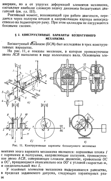

Deskpilot Posted November 17, 2011 Posted November 17, 2011 Referred to as a con-rod less motor. I like the sound this 'radial' produces. 1
spacesailor Posted January 29, 2012 Posted January 29, 2012 It has a crank so must have conrods to transfer rotory motion to reciprical. bryan
spacesailor Posted January 29, 2012 Posted January 29, 2012 I like the Commer 3 cylinder 2 stroke motor, NO Cylinder Head! BUT it has 2 crankshafts bryan
Deskpilot Posted January 29, 2012 Author Posted January 29, 2012 It has a crank so must have conrods to transfer rotory motion to reciprical.bryan Not in the conventional way. There are no big end or small end journals. Opposing pistons are joined by a solid assembly. 1
