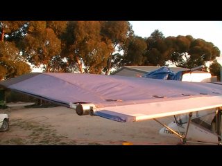

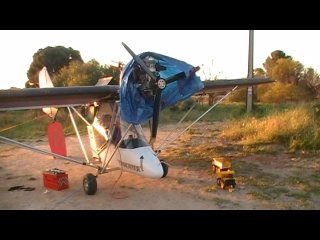

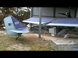

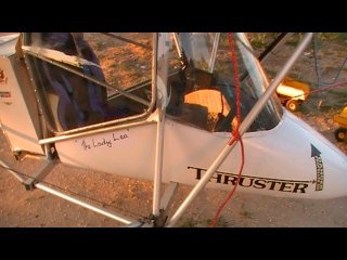

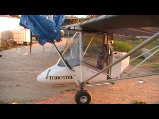

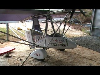

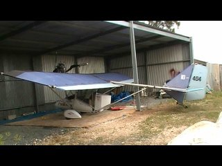

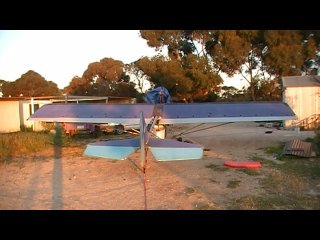

Can anyone help I.D my beast? what Model is this ? Ive tried every where but no go.. waiting to hear from the fellow who took over from Tony but not looking to promising!! I was told its most likely a one of kind modified T83EH(enclosed house)?
I bought it as a T83 and the but old owner had no other info and wasnt 100% on the model.
theres No I.D as it most peoberbly had the boom replaced (as theres no rivet holes for the I.D badge.)
as you can see it has been modified at some stage . mods are fully enclosed cockpit long rang 70-80 ltr tank with aerodynamic fairing and larger wheels and spatts.
ok ,it has the following specs
single seat
engine Robin FUJI 44 ec 50 hp(440cc)
wing span 29.5 ft
area 150sq ft
length18.5 ft
it has 18 top wing ribs
NO bottom Batons just the colaspable frame.
has 2 wing strutts either side with 1 wire support (innermost)
the pod has a join down the centre (halves)with an (origanally black )seal joining the halves(looks like a car seal of some sort).
any info would really be appreciated.THRUSTER1.jpg.bf33bd08fc55a6c0b46bf859fd32057a.jpg

Hi,
It looks like a late '83. Although there were so many changes as they went along. They were built in batches of 5 to 8 and each batch had refinements. Then a lot of the early ones were upgraded to things like larger diameter lift struts heavier compression tubes in the wings etc. I'd like to see a photo of the engine mount. The original fuel tank was just a 20lt plastic drum.
I preferred the Robyn 440 over the Rotax engines that we also used a little later. If the reduction drive is the original it was made up by Lewis Pulleys in Alexandria Sydney. The shaft must be the later version as the early ones snapped at the bearing support. The original prop was a 2 blade wooden Catto. There were also several different winspans.
Tony and I spent many hours going over what knowledge i have on these. All changes were documented by Brian Fimmell and each aircraft had it's production sheet listing the specs., then David Belton later destroyed all the documentation. I am surprised that Tony was able to sort them all out. Good chance that this was built at the Caringbah factory not at the Kirrawee site. So Steve Cohen was probably still involved. if the stainless fittings are original and not the newer type that Tony had made i would keep checking them carefully espesially the wing strut fittings. I never did like the way they were designed and constructed.
Hope this is a bit of a help.
ozzie
Hi,It looks like a late '83. Although there were so many changes as they went along. They were built in batches of 5 to 8 and each batch had refinements. Then a lot of the early ones were upgraded to things like larger diameter lift struts heavier compression tubes in the wings etc. I'd like to see a photo of the engine mount. The original fuel tank was just a 20lt plastic drum.
ozzie

Here's what it appears to be
: Thruster T83 ehf un-finished ( ok origanally a T83)
un-finished because the ailrons were never converted to flaparons(flaparon being the"F" in ehf)
EH being enclosed house.
also the rear boom strutts have been changed with T85 strutts(moved to back of cockpit)
also should note the correct wing span as mesured is accaully 29.6 ft as apposed to my old owner manual stating 29.5 ft..
its more likly a copy but slightly enhanced version of the first and presumed only T83 ehf..
enhanced because the doors and winscreen are a fair bit more streamline ,they do not pertrude if looking from the front ,you can barely see them at all.
I would still like to know the history on this but can't trace the reg number = 10 - 404....who retrofitted it? how many hands has it passed threw?why was the boom replaced and the I.D not re-riveted
and mainly what is the I.D? , oviously 1 of 49 built but what number in that 49?
