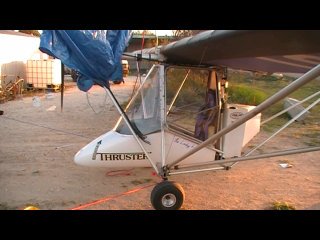

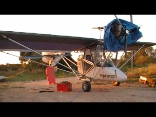

Hello,just did a complete and thourough look over, could not find a plate still and also looked for rivets or rivet holes and nothing?I should mention its still running the origanal fuji robin 50hp and appears to have origanal alloy engine mounts..what has been removed and replaced were the wing box's,new mild steel fitted(raa phoned and noted)..I dont have a lot of history other than it was inspected in 1990 at mt,gambier by a Lyall Sharam then in 2009 it was inspected in nsw(somwhere near Sydney),wing box replaced and flown(total 3.5 hours logged),I bought this from another owner with no log book,no licence, (as he was a farm flyer who flew it on his own property{apperentlythe raa rules state no licence or reg required if flown on and within own property} wich he flew the day of purchace. other than that all I know is its a modified T83, one of 49 built...modsP12.jpg.b1315e34c161f44d560decacbf0c38de.jpg are : endurence tank and spoiler fitted, rear cabin new full alloy sheet fitted(to fill in cockpit) new doors fitted and a 3 blade brolga fitted..I was yold this eas done very early in its life..?
Hello,just did a complete and thourough look over, could not find a plate still and also looked for rivets or rivet holes and nothing?I should mention its still running the origanal fuji robin 50hp and appears to have origanal alloy engine mounts..what has been removed and replaced were the wing box's,new mild steel fitted(raa phoned and noted)..I dont have a lot of history other than it was inspected in 1990 at mt,gambier by a Lyall Sharam then in 2009 it was inspected in nsw(somwhere near Sydney),wing box replaced and flown(total 3.5 hours logged),I bought this from another owner with no log book,no licence, (as he was a farm flyer who flew it on his own property{apperentlythe raa rules state no licence or reg required if flown on and within own property} wich he flew the day of purchace. other than that all I know is its a modified T83, one of 49 built...mods[ATTACH=full]15147[/ATTACH][ATTACH=full]15148[/ATTACH] are : endurence tank and spoiler fitted, rear cabin new full alloy sheet fitted(to fill in cockpit) new doors fitted and a 3 blade brolga fitted..I was yold this eas done very early in its life..?
Like Corky said it should have a 4 digit number starting with the number 1 on the end of the engine mount usually the front left hand side one. The numbers are not real big. For example if your t83 is the 49th built it's number will be 1049, certified 2 seaters have the ID plate like Pud mentioned.Cheers Steve.

JUST BEEN GIVEN A LOGICAL EXPLANATION............. NOT the origanal boom ... ah of coarse ..why didn't I think of that?
well they could have re-riverted the i.d back on ofater stacking it ,,proberbly a ground loop
