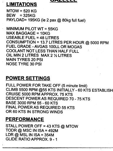

Guest micgrace Posted May 28, 2006 Posted May 28, 2006 Hi Ian I recall somewhere in the flight manual for the Gazelle (wi 912 A1, A2, A3), not to use AvgasLL unless that's all that's available. Page 8 ......... Fuel Grade: MOGAS (SUPER) or AVGAS Low Lead........ (MIN RON 90) ..... or AVGAS 100 LL (Then it contradicts itself) typed directly from the flight manual "Due to the higher lead content in AVGAS, the wear of the vavle seats and deposits in the combustion chamber will increase. Therefore, use AVGAS only if problems occur with vapour lock or if MOGAS is not available." Bit strange don't you think? Micgrace :)
Admin Posted May 28, 2006 Author Posted May 28, 2006 Very strange Michael, I know of several Gazelles that only run Avgas (Wangaratta, Tyabb etc) and I do know that like all Rotax's that if running Avgas you need to change the oil every 25hrs though

Guest Fred Bear Posted June 19, 2006 Posted June 19, 2006 I believe the information in the first postisincorrect - what you have posted is not from the Gazelle flight manual. It looks like it has been created / transposed by an owner or operator. The stall speed of the Gazelle at MTOW is normally 45 knots. I would be interested to know why what you have posted says 43. Also, Rotax 912's in general should be run on Premium unleaded if and when available. Changing the oil at 25 hours is a goodidea, however the lead does damage to the engine. Bert Flood's will happily provide you with further information on this if required. Perhaps a thread on this in engines might be appropriate. I believe inGA however, schools must use Avgas for charter / air work. ClemBrown
