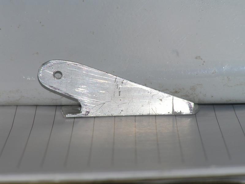

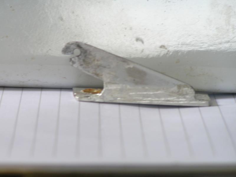

Guest rocketdriver Posted March 27, 2011 Posted March 27, 2011 Well, I think he did! ...... On Friday we had a condition report done on one of the aircraft we recently imported. Our intention was, and still is, to fly the thing in a month or so, and both Ray (my partner in crime) and myself felt the time was right to start the formal preregistration activities. We had already extensively surveyed the aeroplane (we thought), had found and fixed several things and I guess we felt that she was pretty right for flight .. just a few little thing left to do ...... So there we were, the inspector poring all over the aircraft, me thinking “don’t find anything ...its more work and anyway, everything is ok .... but then, if there is something wrong, please tell me so I don’t crash on first take off ....” and Mick, politely and professionally ignoring the owners’ emotion, carefully surveying the aircraft. It really is a two edged sword ... you don’t want anything to be wrong, but if there is, you want it pointed out to you ....... but please, don’t find anything wrong! ..... Anyway, amongst other things , (not many but enough!), Mick said we should look carefully at the elevator trim tab, in particular the connection between the trim tab and the trim tab control cable .... The steel clevis looked quite rusty. So today I took it all apart .... The rusty bit was just rusty ....cleaned it up and painted it with kill rust ..... BUT. The control horn, made of aluminium, was a bit corroded ..didn’t look very serious, but sandpaper wasn’t making much impression.... so I got a small screwdriver out to scrape away the worst of the “surface” corrosion, and, to my HORROR ..... see the picture, photo1. Photo 2 is what it is supposed to look like ... The pin attaching the cable tom the control horn would have just pulled straight through..... This was just a gentle scraping with a screwdriver on something that looked at first (inexperienced) glance to be perfectly serviceable ..... Never seen exfoliation before. I was able with very little effort to separate layers of aluminium from something that looked for all the world like a normal piece of aluminium sheet .... like peeling off layers of plywood .... Heard of it before, but never seen it ..... Hate to think what might have happened if I had gone flying with it like that. THANK YOU MICK Needless to say, a new control horn is in process of being assembled to the trim tab ....
Guest Maj Millard Posted March 27, 2011 Posted March 27, 2011 Good story Rocketdriver, Chances are the corrosion was initiated by the steel pin, also referred to as disimiliar metal corrosion. And chances are your L2 has a lot of experience, and has seen this type of problem many times before. The thing with an experienced person is they know where to look, so it's really money well spent.Good find Mick !....................................Maj...
Guest Andys@coffs Posted March 27, 2011 Posted March 27, 2011 My trade wasnt framie so not too sure but the thing that would concern me is, if there was corrosion in that location to that extent is it indicative that a more thorough inspection for corrosion is required elsewhere? I understand the dissimilar metals point that major made, but wonder if the conditions were right for corrosion here whether that would hold true elsewhere as well... Andy

Guest rocketdriver Posted March 27, 2011 Posted March 27, 2011 Hi Andy ... big thing for me is how inconsequential the slightly rusty clevis looked and how the real problem was completely hidden behind the fitting .... And , yes, there are a couple of other corrosion type issues, but the a/c is 30 years old, has not done a lot in the last 10 years and has been sitting in a hot / cold Canadian hanger for most of that time I suspect ...

dazza 38 Posted March 28, 2011 Posted March 28, 2011 Galvanic Corrosion ( also known as Dissimilar Corrosion). Needs 3 things for it to happen. A) Electrochemically dissimilar metals must be present eg- Steel pin touching aluminium. B)These metals must be electrical contact Ie- touching each other. C) The metals must be exposed to a electrolight Ie- Moisture If you break one of the above, you can avoid the problem. Example- A barrier between the two parts- eg- paint, grease etc. preventing both metals touching each other.As one metal is more Noble than the other one. Possibly in the above case- coating the pin in paint, and keeping a eye on it. Cheers Ps- This is for general information.
Thruster87 Posted March 28, 2011 Posted March 28, 2011 Exfoliation is a special type of intergranular corrosion that occurs on the elongated grain boundaries. The corrosion product that forms has a greater volume than the volume of the parent metal. The increased volume forces the layers apart, and causes the metal to exfoliate or delaminate. However, in certain conditions, the grain boundaries can undergo marked localized attack while the rest of the material remains unaffected. The alloy disintegrates and loses its mechanical properties. This type of corrosion is due either to the presence of impurities in the boundaries, or to local enrichment or depletion of one or more alloying elements. For example, small quantities of iron in aluminium or titanium (metals in which iron has a low solubility), segregate to the grain boundaries where they can induce intergranular corrosion. Certain precipitate phases (e.g. Mg5Al8, Mg2Si, MgZn2, MnAl6, etc.) are also known to cause or enhance intergranular attack of high strength aluminium alloys, particularly in chloride-rich media.
