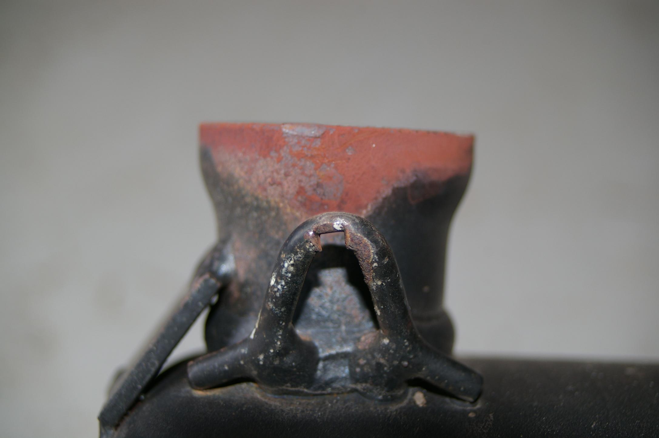

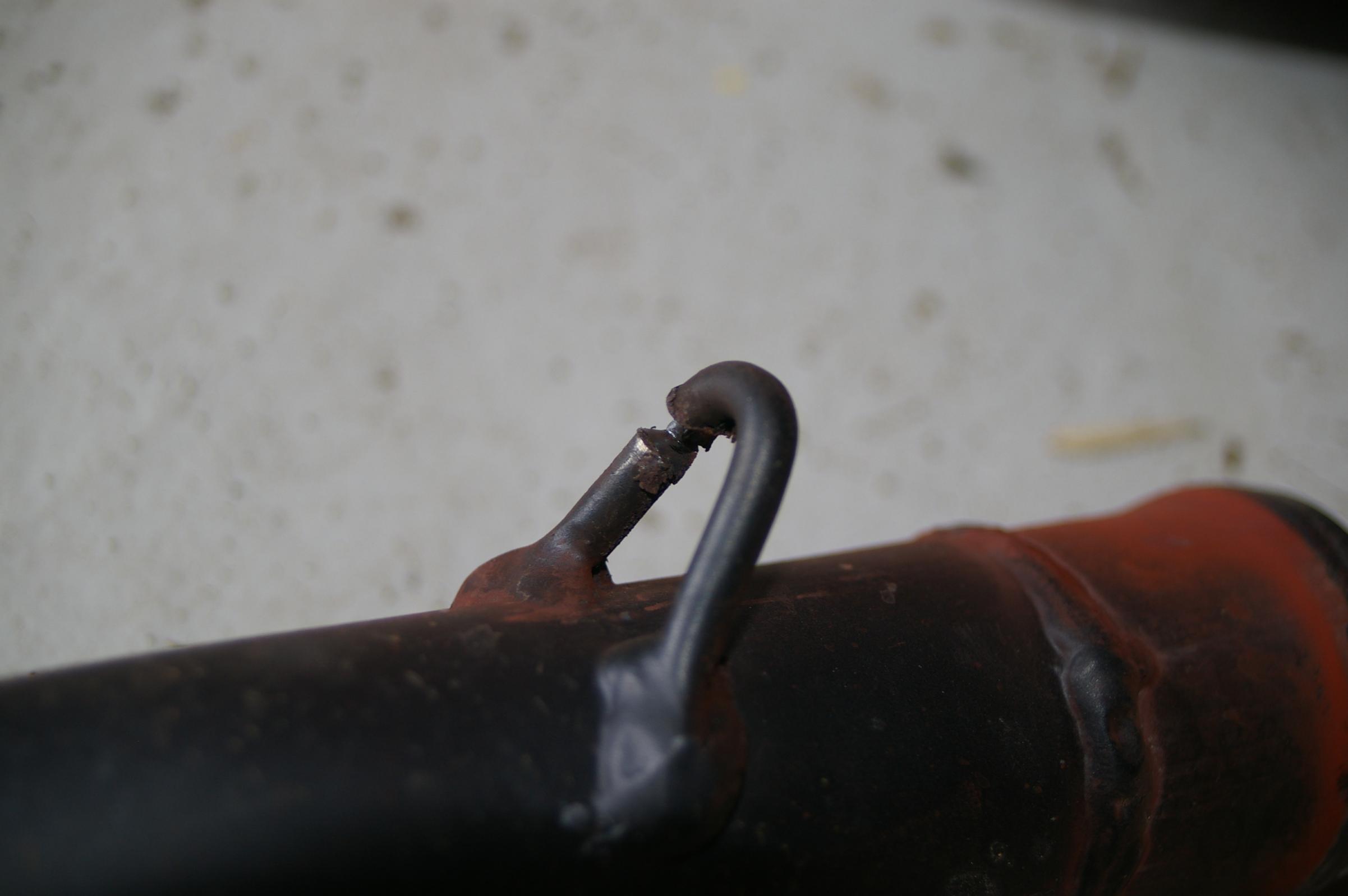

I have ordered the carbie syncing kit from airborne and plan to check the carbies before I fly again. Attached are the photos of the damage done to the exhaust lugs by the spring on the underside of the exhaust. This spring is the most difficult to check properly in preflight. Now that I know exactly what to look for, I don't think I will miss [ATTACH]12740.vB[/ATTACH]that sort of wear again. Airborne are pretty sure that the damage done is from out of sync carbies. I'll find out pretty soon if that is true.
Bluey[ATTACH]12739.vB[/ATTACH]
