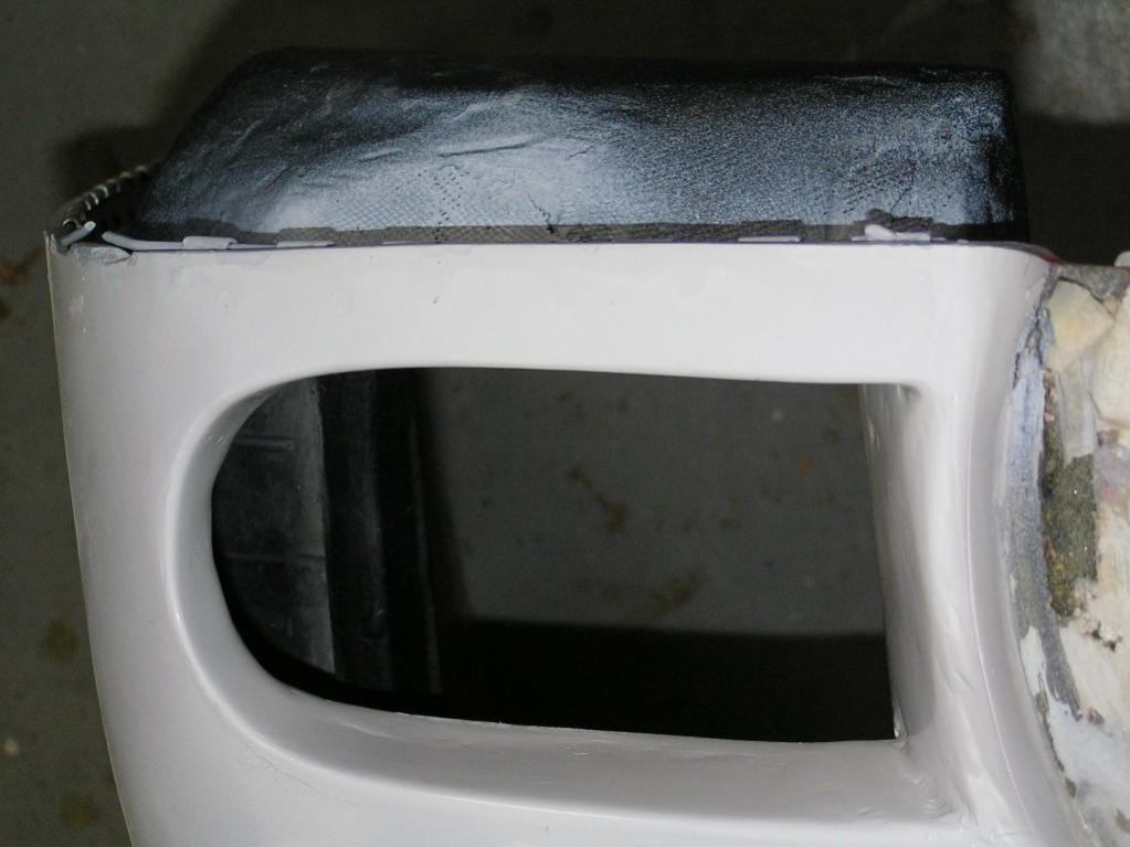

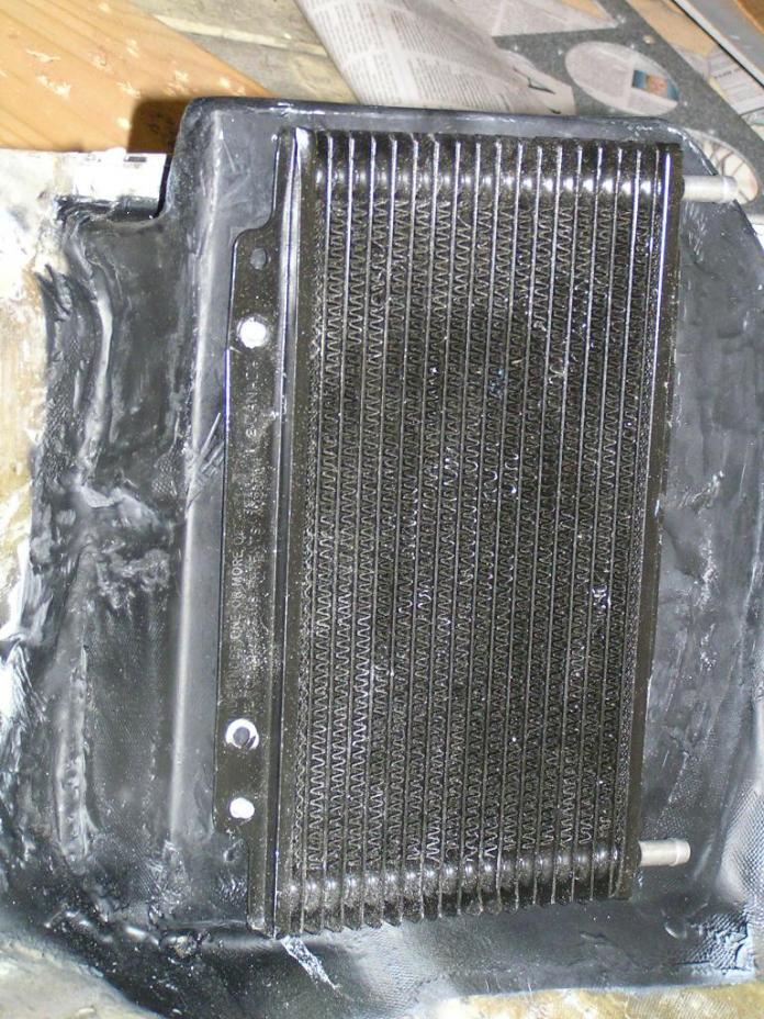

How we are fixing the oil cooler ....
Oil cooler. When the aircraft arrived, the oil cooler was strapped to the two oil lines that run to and from the oil filter which has previously been “remoted” to the front of the engine on the starboard side. The cooler sort of dangled in the breeze coming through one of the cowl openings and all the oil always flowed through it ...no thermostat.
We decided to make a plenum behind the starboard opening in the lower cowl (next to the spinner) and mount the oil cooler off that using 4 nuts on captured bolts fixed to the plenum. Means we will have to dismount the cooler in order to remove the lower cowl, but the oil lines can stay intact during that process.
The plenum was made by carving a shape in Styrofoam, then covering the shape in duct tape before applying a layer of epoxy mixed to a paste with micro beads of glass followed by a single layer of glass fibre.
After curing, A trial fit with the cowling in place on the aeroplane enabled the position for the captive (6mm) bolts to be determined and a piece of 19mm sq pine was glued on the inside of each sides of the plenum to carry the bolts. After drilling the bolt holes, nut plates (to hold the bolt heads) were made from lightweight aluminium sheet and the bolts, cut to length, were glued in place using flox to hold everything firmly in place.
To smooth the airflow into the plenum, a piece of dowel was glued to the top and bottom inner edge of the cowl opening to make a lip for the air to flow around, and this lip was continued around the round corner of the cowl opening using flox.
Before gluing the plenum into the cowling, the old oil and grease needed to be cleaned off ... lots of hot water, washing up liquid, a scrubbing brush and plenty of elbow grease did the trick ....
Due to the Redrive, the plenum and oil cooler needed to be offset a bit and so a ramp was made for the straight edge of the cowl opening to guide the airflow into the chamber. Again, styrofoam and glass fibre was used.
Then some filling and painting. The finish is not great at this stage, as the goal is to get the aeroplane flying. There is other cosmetic work needed on the cowl and this might be a project for next winter.....
We have also purchased and await delivery of a thermostat system that fits onto the remote oil filter housing. This works by diverting more or less oil through the cooler according to the oil temperature and will make for quicker warm up and eliminate overcooling in cold weather.

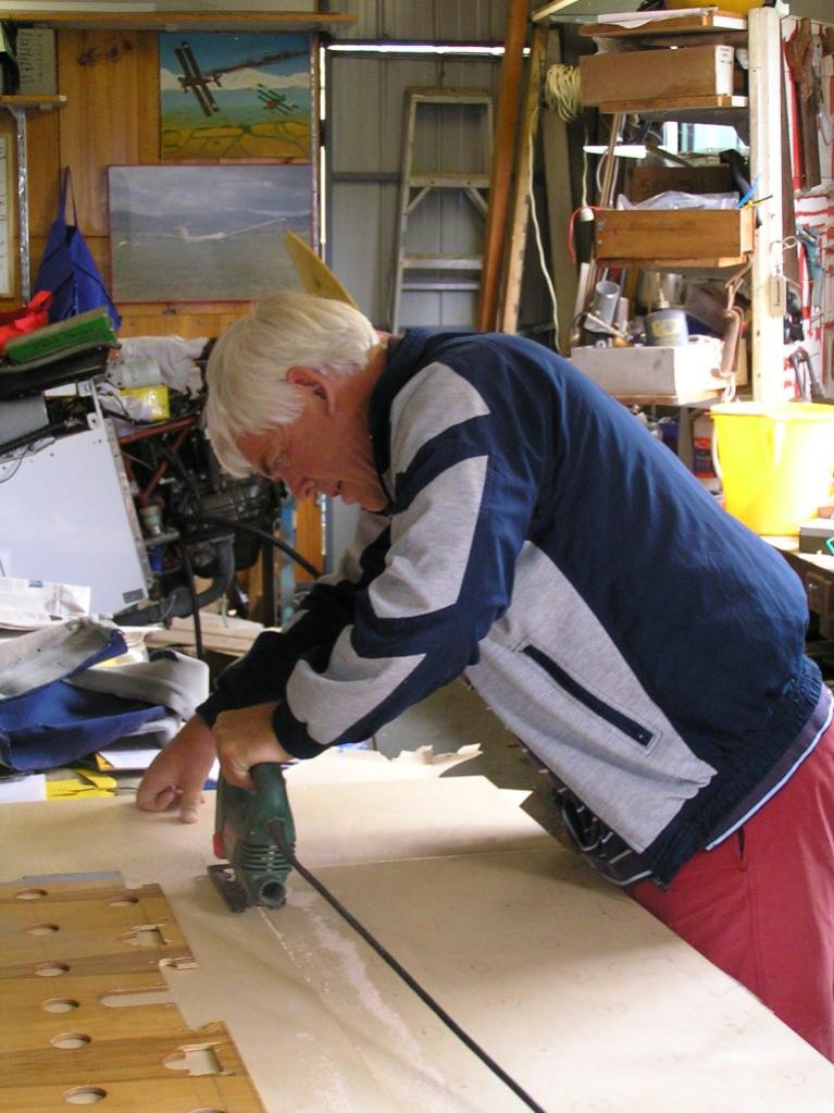

When we first tried the cockpit of CJI for size, both Ray and I found a very upright seating position, uncomfortable and too close to the panel. Comparing CJI and ROK, we noted that ROK has a narrower parcel shelf than that in CJI. We determined that by narrowing the shelf we could rake the seat back with benefit to both seating position and controls access.
As of Dec 20th, we have narrowed the shelf and are in the middle of cutting out the new seatback.

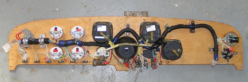

New panel
Again when trying out the cockpit for size, both Ray and I found our knees to be painfully pressed into the bottom of the panel. We also noted a number of redundant, odd or out of service instruments (some with senders strapped together to part of the engine bearer). We decided that a new panel would be in order, with a new set of matching engine instruments using concepts I have previously used to create an easily removed panel with secure automotive style plug and socket connections. Using this concept, the instrument panel is almost self contained with only about 10 connections going off to various places in the engine bay, plus of course the pitot and static tubes.

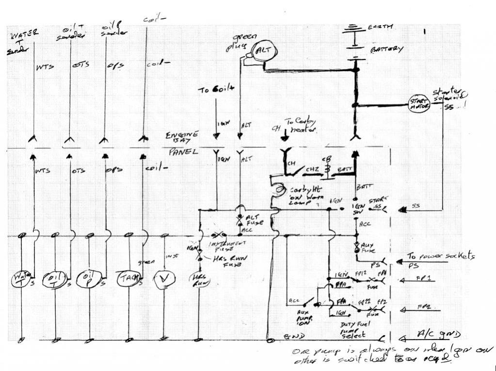

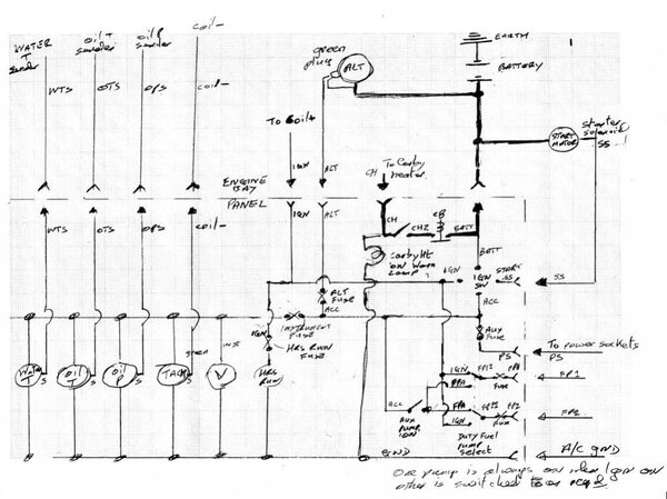

After a trip to Burston Auto Parts we ended up with a full set of matching instruments, all electric and all with their own senders. A trip to Jaycar secured some wire, cable ties, heatshink tube and plugs and sockets....
Using the instructions for the new instruments, and following a longish session in the engine bay and cockpit with multimeter and test leads, we were able to work out what we needed for a wiring scheme. (Both aircraft came with very little documentation, so we are working things out as we go!) The planned wiring diagram is shown below for interest. I will be able to remove a lot of wiring from the aircraft, especially as we don’t need the landing lights for day VFR (see picture of the cockpit with the panel stripped off the ‘plane)
One item of interest that I haven’t seen before is an electric Carby heater. It seems to be something that will be of more help to start the engine on a very cold morning than something to prevent icing, as it is a pad fitted between the carby and the manifold ..... The pad clearly has heating wires in it as the electric circuit that feeds the heater is rated at 25 Amps .....

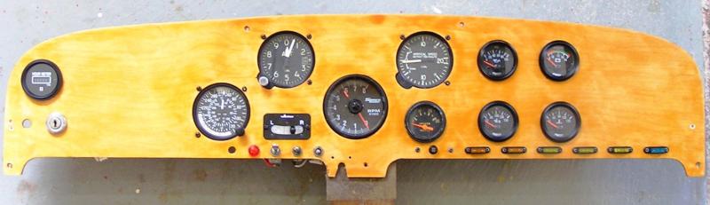

For a panel layout, we cut out some shapes from light cardboard ... instruments, switches, fuses, throttle, choke, radio, GPS, etc and shuffled them around on an outline drawn onto some scrap plywood which had been cut to the proposed new panel size and shape.
So now we are ready to cut wood. Yes it’s going to be a wood panel, not aluminium as was the original, and it is expensive 7 ply birch grade AB/B. We will cut it so the grain runs horizontal across the panel, and will use marine varnish to finish it. Should look nice!

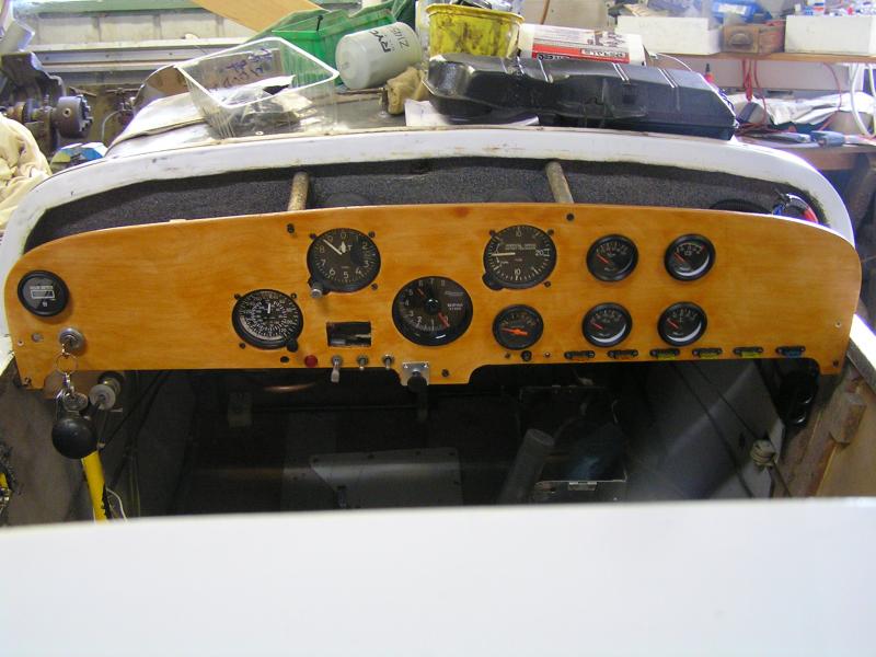

Well, except for the labels, the panel is now finished, with pretty much the whole electrical system for the aircraft on the back. You can see the 4 plugs that connect the switchery and instruments to the sensors etc. There are 10 signal wires, two high current connections and the instrument earth.
The choke cable fits into the little vee at the bottom of the panel and is secured by a little ss cover plate whilst the throttle and Battery master are located off the main panel. This makes the panel easily removable for maintenance and cockpit access.
After checking for short circuits, I applied a 12 volt power supply to where the battery connects into the aircraft, and lo and behold, the panel sprang into life!017_happy_dance.gif.8a199466e9bd67cc25ecc8b442db76ba.gif
