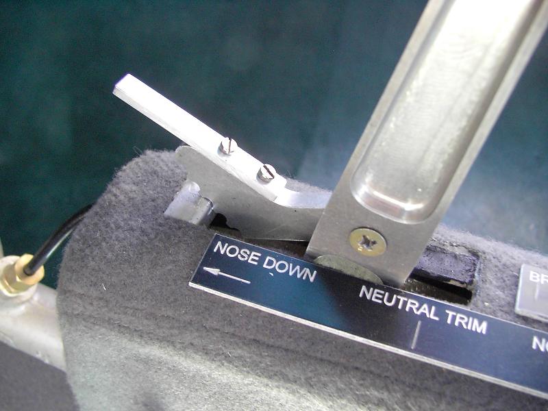

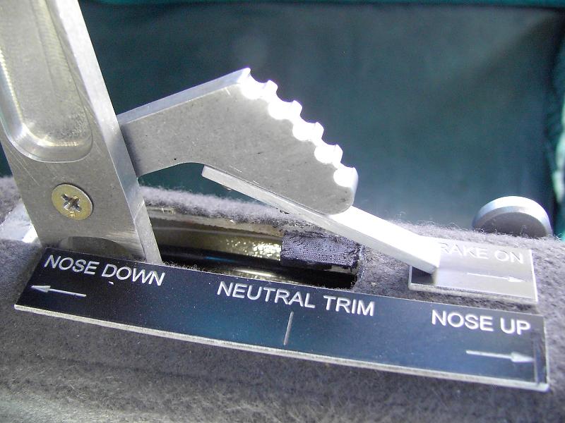

BigPete Posted February 10, 2007 Posted February 10, 2007 My Brake Mod This is how I solved the problem of the missing ratchet. Just a small strip of aluminium screwed to the top of the ratchet. regards
