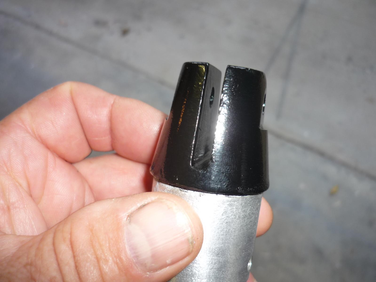

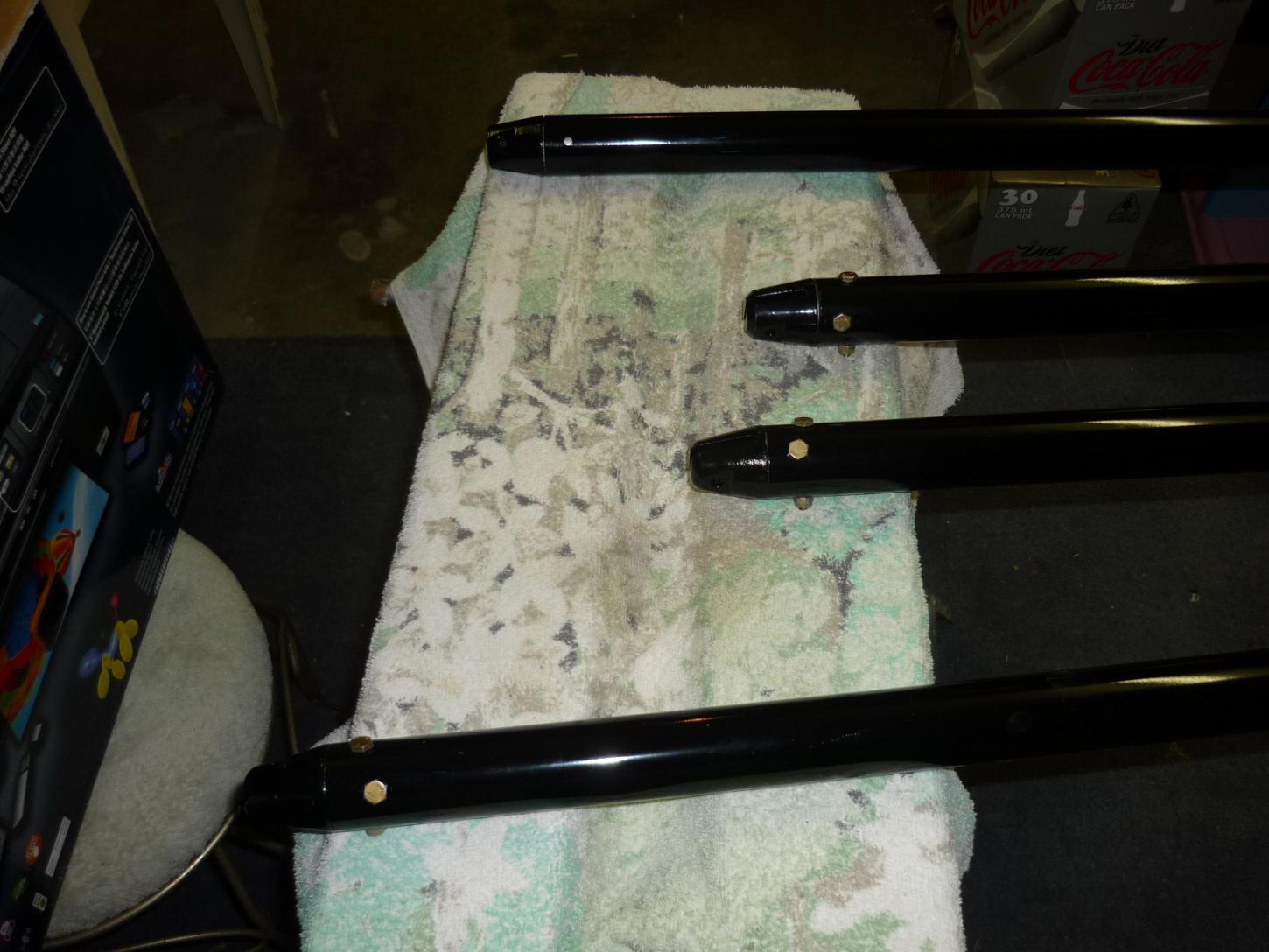

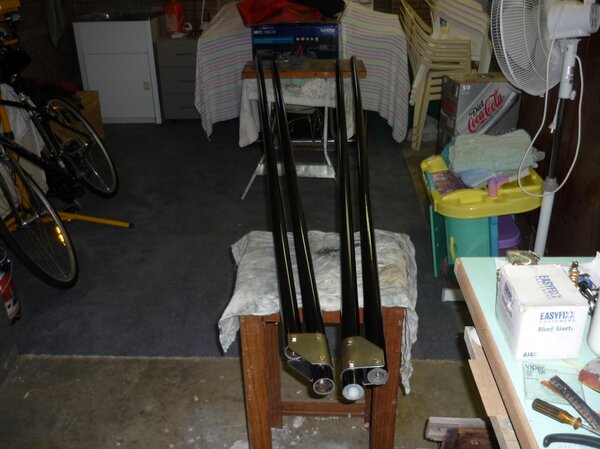

pudestcon Posted November 8, 2010 Posted November 8, 2010 G'day Bob, Yeh it does seem a bit cheeky by the manufacturer I'd agree. I wonder who manufactures them in Australia now - the alum. plug I mean. The plugs on my struts are not anodised and did not show any signs of the type of corrosion referred to in the order. Here's a couple of photos of my 'work in progress' on the struts. Pud

xair1159 Posted November 14, 2010 Posted November 14, 2010 Pud, A thought having viewed the photos of your artistic endevours: I was involved in getting an a/c through UK "Section S" approval and one thing mentioned is paints and coatings. Whatever you use, paint or powder coating etc. it must be brittle and not flexible or cracks in the base material could be masked until it is too late. Nick

pudestcon Posted November 29, 2010 Posted November 29, 2010 Pud,A thought having viewed the photos of your artistic endevours: I was involved in getting an a/c through UK "Section S" approval and one thing mentioned is paints and coatings. Whatever you use, paint or powder coating etc. it must be brittle and not flexible or cracks in the base material could be masked until it is too late. Nick G'day Nick, My apologies for not replying sooner; I did read your post and thought I'd come back to it, and never did until now. The paint I've used is just enamel gloss over an etch primer - both from a pressure pack spray can. I didn't think about flexibility of the paint. I reckon though, that the enamel paint, whilst having some flexibility, would not be as flexible as an acrylic paint. Luckily the connection points are very easy to get to for daily inspections so that's a plus. What is your view on the paint I have used? Pud
