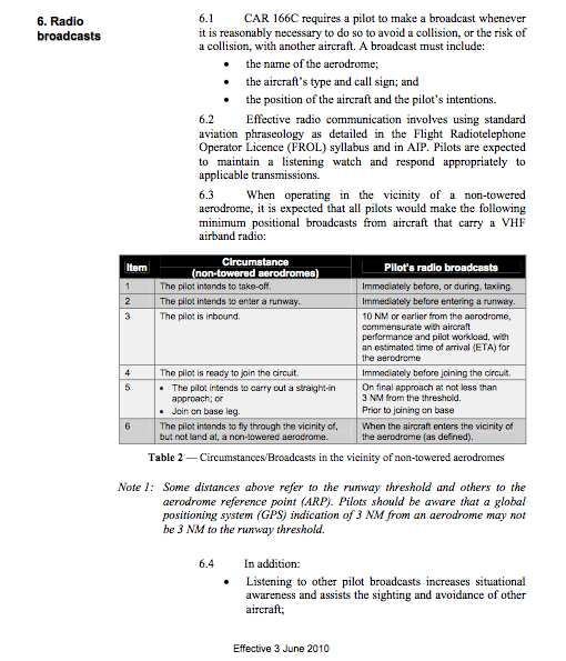

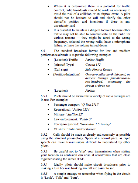

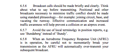

CAAP 166-1/166-2 From the RAA website.
Also John Brandon has put it quite nicely in here
The CAAP 166-1 Page 19, section 6 states -

Copied for you - go to above link to get to original source.
Hope that helps any.
