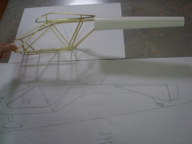

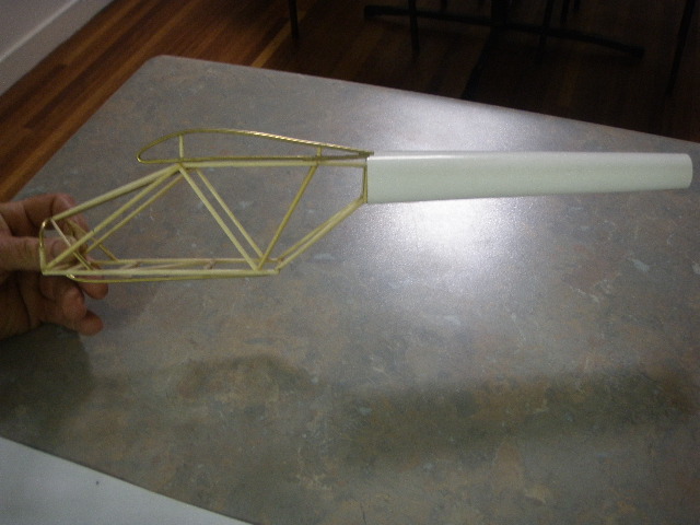

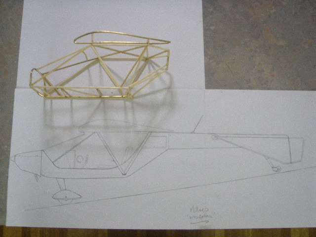

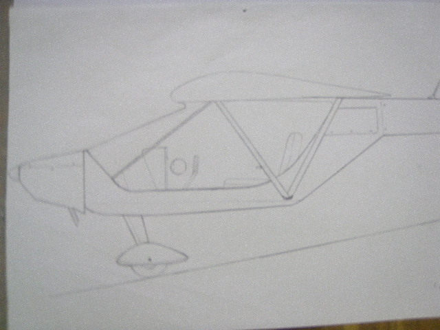

Guest Maj Millard
Preliminary work so far,.............................

Hey Maj,
I like the look of it :thumb_up: The seat looks a way back though
Cheers
H
Hi Maj
Looks great! Love the concept! will you have full length flaperons, as per Foxbat, will you employ negative flap to assist with top end speed, maybe even a trim able tailplane to decrease drag in the cruise. Oop's just flexing the grey matter, not trying to move in!

Mr H...Yes I'm looking at the seat position also, remember it's a two seater, side by side, and the tail only has two surfaces instead of the usual three, so should be a bit lighter than normal. Early times yet, things still changeable.
Blueshed (love that name)...I understand the advantages of the full length flaperons as I have flown the Kitfox, and also the savannah has them, to good advantage. And of course the Foxbat uses them well also. Currently will go with long (3/4) flaps with separate ailerons ALA Cessna Caravan, as it also has a highly loaded wing as I suspect mine may be . Yes I definitly will have reflex flap for cruise as it is one of the few 'free rides' in aircraft design and works so well also. Not sure about a trimable tailplane at this stage..................Maj...024_cool.gif.7a88a3168ebd868f5549631161e2b369.gif
