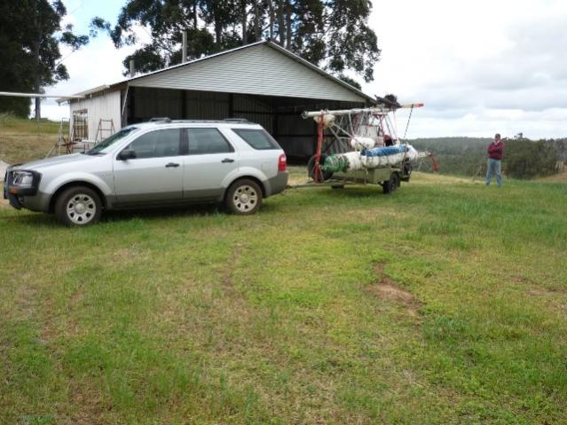

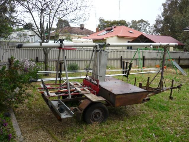

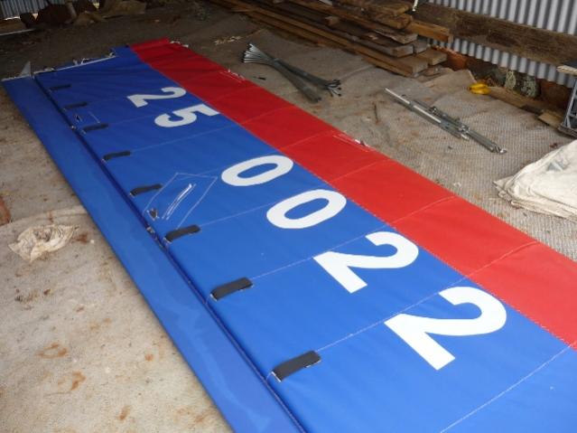

I am involved with restoring a T500 at the moment and it is a challenge at times to source parts at a reasonable cost. I have had stainless steel parts made up by ss specialist fabricators from sample parts I have provided; same goes for things like chrome moly jury struts. Obviously AN grade bolts can be sourced from aircraft hardware suppliers as can the aluminium tube we need for Thrusters. Skins can usually be produced by yachting sail makers in dacron or ultralam. The Clear Prop shop accessed from the this web site is also a good source of parts such as instruments, wheels and tools you might need.
Good luck with it if you decide to proceed and check out the photo below of my pile of tube before commencing the restoration.
Pud

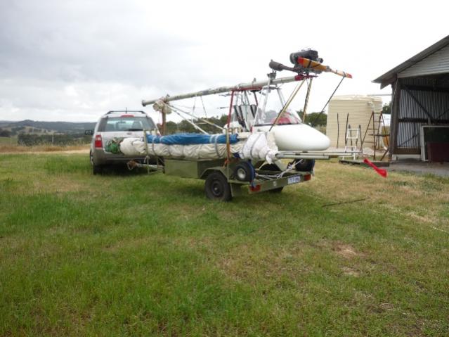

This is by way of preparative homework as I don't currently have any specific aircraft in mind but as I want a project and possibly have the skills, it probably won't be a fly away when I find it ..... so. Dimensions. If I find the right a/c and its in the middle of Woop Woop, what size truck/trailer do I need?? what size does the fuselage break down to? wings? ... I guess you de skin them and roll the tubes into a bundle? How long? All thoughts welcome so that, come the day, it all runs smoothly (HA HA HA!!)

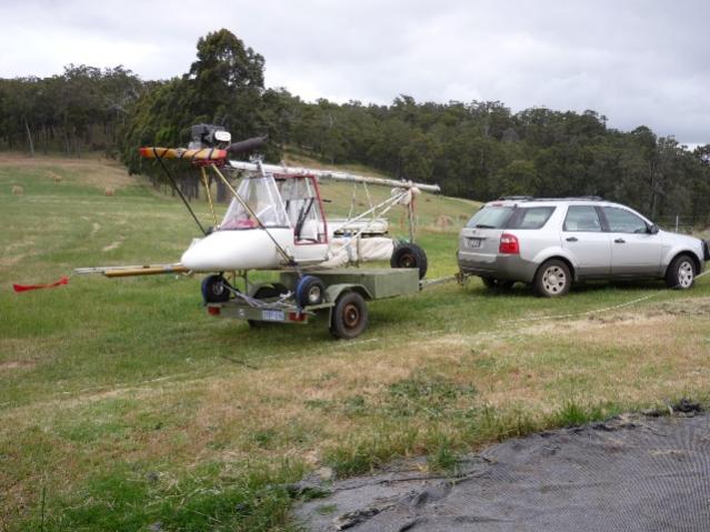

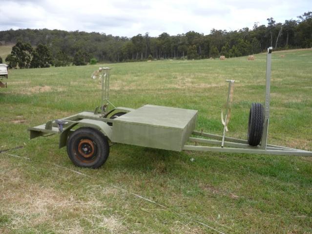

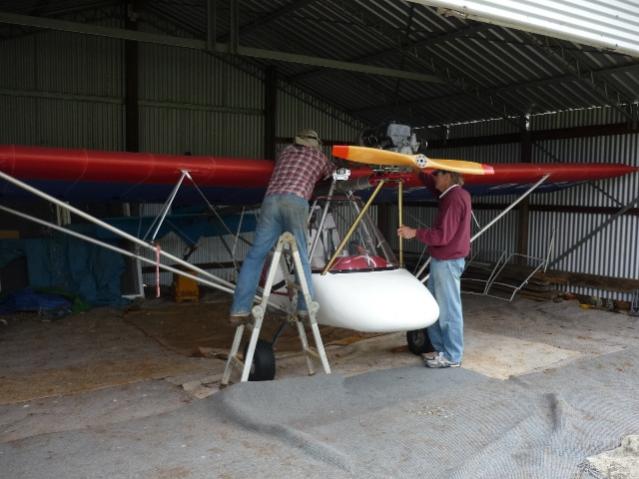

Well Rocketdriver, I guess it really depends on the aircraft you eventually buy but the trailer in the photo above is a purpose built trailer for moving Thrusters.
Here are some photos of a 'move' for a Thruster Gemini I was involved with last year.

Well Rocketdriver, I guess it really depends on the aircraft you eventually buy but the trailer in the photo above is a purpose built trailer for moving Thrusters.Here are some photos of a 'move' for a Thruster Gemini I was involved with last year.

Just one thing on the trailering, wouldnt turning the machine around be better, as then the wind is not behind the screen, trying to tear it off?
I will put some pics up one day of a build i done in the shed.
You would certainly think so bones. The trailer we used was purpose built for transporting Thrusters and that is the way you load the aircraft on this trailer. I must say it towed really well with no issues from driveability or damage to the aircraft at all. Wind resistance was not an issue in this case but this aircraft has a see through polycarbonate rear bulkhead that would have helped not tear off the windscreen.
