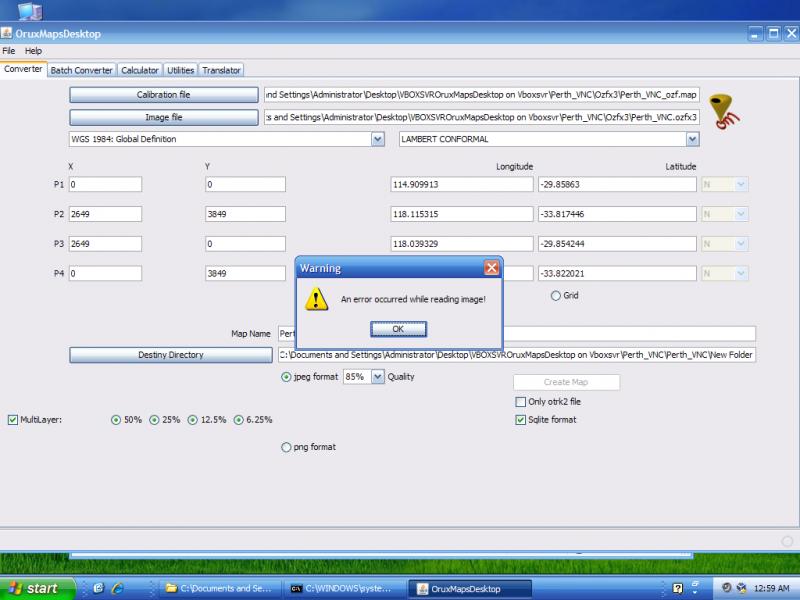

It's strange, I get a "Can't find image file. Use Search image file button" when there's clearly a path to the .ozfx3 file, then I hit ok and it says "An error occurred while reading image" Maybe it doesn't like Windows 7?

I have been having the same dramas as well,,, batch converter just does not want to seem to seem to co operate, anyway ,,,will keep trying
Brett are you using Windows 7 as well?
I'm going to create a virtual environment with XP installed and test it. I'll get back to you.
-Andrew
I can confirm it's not working with Windows XP either.

mmmmmm
maybe I was wrong ( I did say it was quickly from memory - sorry)045_beg.gif.b05ea876053438dae8f282faacd973d1.gif087_sorry.gif.8f9ce404ad3aa941b2729edb25b7c714.gif
I looked in my working directory and there are *.png files
when I tried to use the ozfx3 file I got the same error (using XP)
I remember doing the 1st map using a long winded method then finding the quicker way that was quite simple and quick
Just have to work out how the *.png files got there. ( may have been a batch convert, I certainly didn't do them one at a time :confused:)
OK searched further
I may have used a program called demapper.exe as it is in the Oruxmaps desktop directory and seem to generate the *.prn files required for the image files

Thanks for your help Tracktop. I've had this error before but DeMapper keeps crashing when I click 'decode maps' on either Windows XP or Windows 7. I can't seem to send an email to the developer either. I might try installing a .NET framework on my XP virtual box and see how that goes.
EDIT: .NET Framework install was no help

Just a thought
Try using just one file ( VNC or VTC) at a time ands see if that works
( again from memory only )
I get an error if I select the full set as there is one ( at least) map file without a supporting file (??? maybe the TAC's)
If it is trying to do that first it may produce that error

I might try installing a .NET framework on my XP virtual box and see how that goes.EDIT: .NET Framework install was no help

If it is dependent on DotNet, don't forget that programs are version dependant. That's why you end up with every version of DotNet on your PC instead of just the latest :-(
It's one of the things that I hate about DotNet.
DeMapper is from http://terraperfecta.com/demapper.php (I've never used it, just Googled the name.)

Yeah I'm only trying to convert the Perth VNC. It's driving me crazy 031_loopy.gif.e6c12871a67563904dadc7a0d20945bf.gif

I got version 3.5 and judging by the applications complexity (not much :P) I think this should be sufficient.
