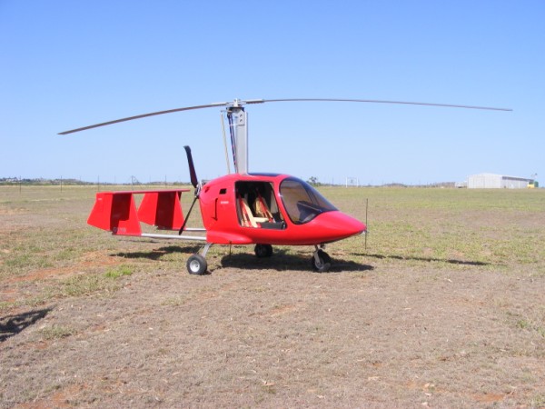

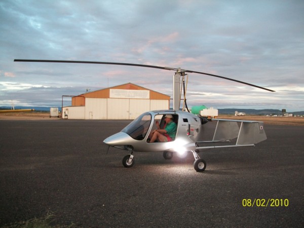

bones Posted July 13, 2010 Posted July 13, 2010 Be the same as this but a fraction different colour, new one is silver , loved the red but damn too hot for up here if its sitting on the ground for anylonger than 3 mins, sold it to down mid NSW, so gone for a cooler colour this time. Actually i found a pic of the near exact colour mine will be this is one of the last i delievered. Now this is a nice colour, and how assy is this that i got the strobe on too

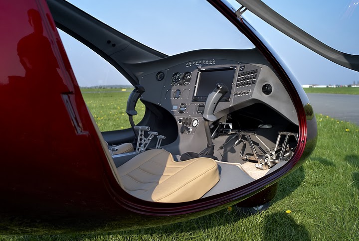

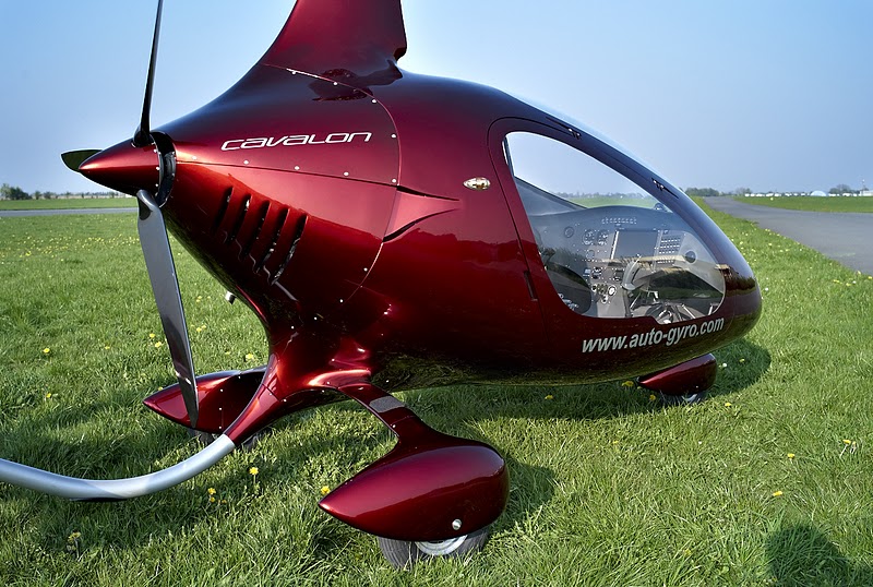

Guest Howard Hughes Posted June 2, 2011 Posted June 2, 2011 That is a nice looking machine Hunter, in fact it is a lot sleeker looking than the Xenon, but will I lose half my prop if I make a mistake? PS: Just did a Google search, do I get a trial flight?
HunterJ Posted June 2, 2011 Posted June 2, 2011 The first one is due into the country late August so any time after that for your trial flight. Clearances are such that your prop is safe. Cheers HJ
